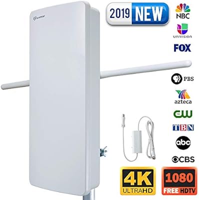

The Antop 400-BV antenna has renewed my faith in OTA service.
It was purchased to be installed on the roof, but currently sitting on top of a stereo cabinet in the living room, and performing orders of magnitude better than the AmazonBasics Ultra Thin Indoor TV Antenna - 35 Mile Range, and the AmazonBasics Amplified Indoor/Outdoor TV Antenna - 60 Mile Range, which it replaced.
This antenna is currently unamplified, shared between 2 Tablo OG 4-tuner units, and picking up stations from 3 different directions.
My regret is not wasting money on the previous antennas, it’s missing out on the performance of the new one.
Like buttah! :slight_smile:
Getting a tingly feeling imagining what it’ll be capable of once installed on the roof.

Someone on Amazon said the antenna sees around 120 degrees.
Welcome to the (Antop) club. I originally purchased my 400-BV with the intent of using indoors (it comes with an excellent pedestal / stand. Ended up going up on the roof with it, but haven’t had to use the vhf crossbar inserts (I refer to it as a “400-B” haha) … I get every station possible without them. I really love Antop product.
Just finished my install. All I can say is that the AT-400BV is a really good antenna. I did a scan with the amplifier turned off and it found 77 channels. With the amp turned on it went to 80 with only a few having less than 5 green dots.
I can now received a low power station that has NewsNet OTA 24 hour news. With the old Winegard Flatwave Air I could not even see that station on a scan!
I left the VHF-H cross bars on since NBC is VHF-H in my market. Comes in nice and strong.

The CS4 is a good antenna. My problem is just the spread between the 2 “tower clusters” I have to use. There’s a bit more than 45 degrees between the 2 locations and the beam width on the CS4 is advertised at something like 43 degrees. Complicated by the fact that one cluster is like 37 miles away and the other is 8 miles. The 400BV is 120 degrees. I should be able to aim directly at the distant towers and still have the close ones within the beam width of the 400BV.
Probably without amplification.
My major networks used to all be at that distant location. There has been some shuffling around and now a couple are sharing towers at the near location.
The 400BV is a longitudinal antenna (looking at the interior, the two reception bays are aligned columnwise). The CV4’s bays are side by side - wider than the 400BV. A wider antenna (like an 8 bay CM4228) has a smaller beamwidth than say a 4 bay (CM4221). So the 400BV may give you a wider beamwidth due to its long physical design.
