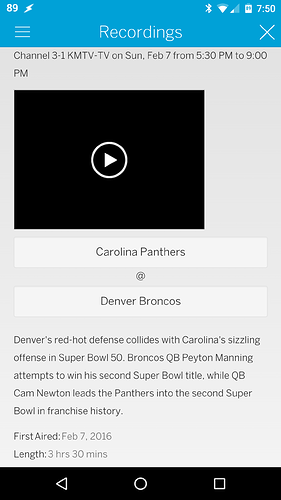

This was brought up in the “extend recordings” thread, but I felt it deserved a thread of it’s own.
The timeslot was 3.5 hours, but the Tablo should have extended the slot to 1.5 times that, which would have been 5.25 hours. Instead, it was just 3.5 hours, so no one that recorded it on their Tablo will see the end of the game.

Yep, that. Maybe CBS hasn’t been marking Recordings as live (Broncos fan, so CBS is mostly what I would record). I almost never see the end of the game. Just wanted to preserve this one since I can. Disappointed.

Each local station decides whether to mark events as ‘live’ and that’s the flag we need to set the extension.
It could be that they didn’t but we’d need to look at each individual Tablo to know.
As for ‘advanced recording options’ this is definitely a popular request that I’m hoping we can tackle sooner rather than later. Unfortunately, the logic could get quite complex!

My Tablo recorded 5.25 hours of the Super Bowl event, which was scheduled for 3.5 hours.
My Tablo firmware at recording time was v2.2.9 Beta 1.
My Tablo also recorded 5 hours 15 minutes of the Super Bowl running 2.2.8 firmware at that time. (I just wish Tablo could set it to skip half time show:grinning:)
