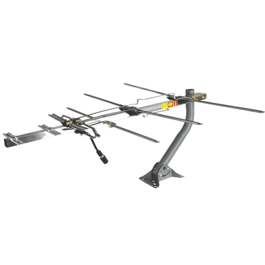

Those rabbit ears are tried and true technology for receiving VHF frequencies. Fox, PBS, ABC and CBS are all in the high-VHF band in Las Vegas. KHSV (MeTV, H&I, Antenna TV, Catchy Comedy, etc.) is on low-VHF channel 2.
For a roof top antenna that covers the low-VHF band try this one.
