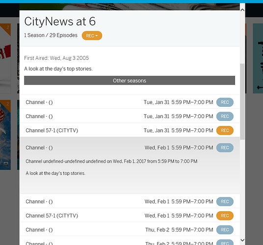

I received my 2-tuner Tablo last week. I got everything up and running easily and the guide worked well and I was able to schedule several recordings. Everything worked great. I then purchased the lifetime guide subscription, and whether or not it’s related, shows are not showing correctly when I select them from the prime time or live view areas. I will see one instance of the show listed, but also another instance of the same thing that says channel - (). Clicking on that, it says channel undefined. Sadly, if I select record new shows, the undefined channel is automatically selected and the show doesn’t record. I have rescanned channels and downloaded the guide again as troubleshooting steps. I’ve also tried different browsers (explorer, edge, chrome), as well as the iPad app. I have 23 channels in the guide. I’m just using an indoor bowtie antenna (from the fifties), but signal is strong and quality is good.
If I’ve uploaded it correctly, here’s a picture of the problem. Any ideas?

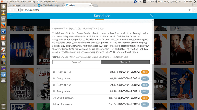

no, go. The tablo failed, lost connection. I reset and got connection back. I still have same issues. Here is one of my views, scheduled recordings look a little different, but most look like this from Chrome.
Other times I get view just like webeye. Other times it says no data (or something like that), sometimes I get the title multiple times, same date and time.
