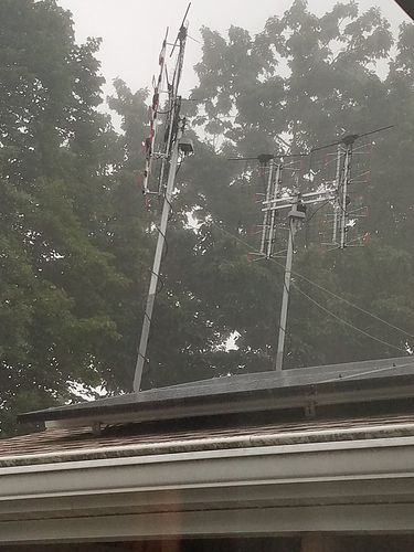

I wen’t nuts with mine (all tool time) and purchased two massive antennas
I bought two of these 8 Element Bowtie Antenna
Those are only UHF antennas, so I then had them connect into a VHF antenna so I bought one VHF for each of those VHF Atenna
I then had both of them go into two pre-amps. Reason two is you want them as close to the antenna as possible so I have each of the mounted just below the black box you see in the picture of the 8 Elements Bowtie. Pre-Amp Channel Master CM-7777
I then combined the signals from the two antennas about 10 feet from each antennas using this DC/IR passthrough combiner. This needs to be a DC passthrough for both routes so the power can reach the pre-amps (yes one pre-amp power supply can provide enough power for both amps) Channel Plus DC/IR Splitter/Combiner
Finally just get any coaxial cable that is Quad Shielded, do not forget to ground that wire before it enters your house if not you may get a surprised FRYING from a lightning bolt.
With that setup (which I went completely overboard) was to help me point one of those antennas to DC and the other toward Baltimore. I get over 80 channels and 99% come in crystal clear with no problems. The last 1% are because they are comming out of Pennsylvania so it just depends on the time of day because the distance is huge (200+ miles away).
Point is, don’t go cheap on the antenna. Go all in, I did and it cost me allot of upfront costs but I do not regret it.
EDITED: I forgot to add one really important thing
The coaxial line from the antenna to the Combiner from each antenna must be the exact same distance. If not you could get ghosting on the TV because one antenna is behind than the other.
EDITED: Added some pics as request (it was foggy and I took them this morning)

Nice write up but we would love pics of your setup rather than just links to the equipment. How are are you from DC and Baltimore?
Done, uploaded to first post.
