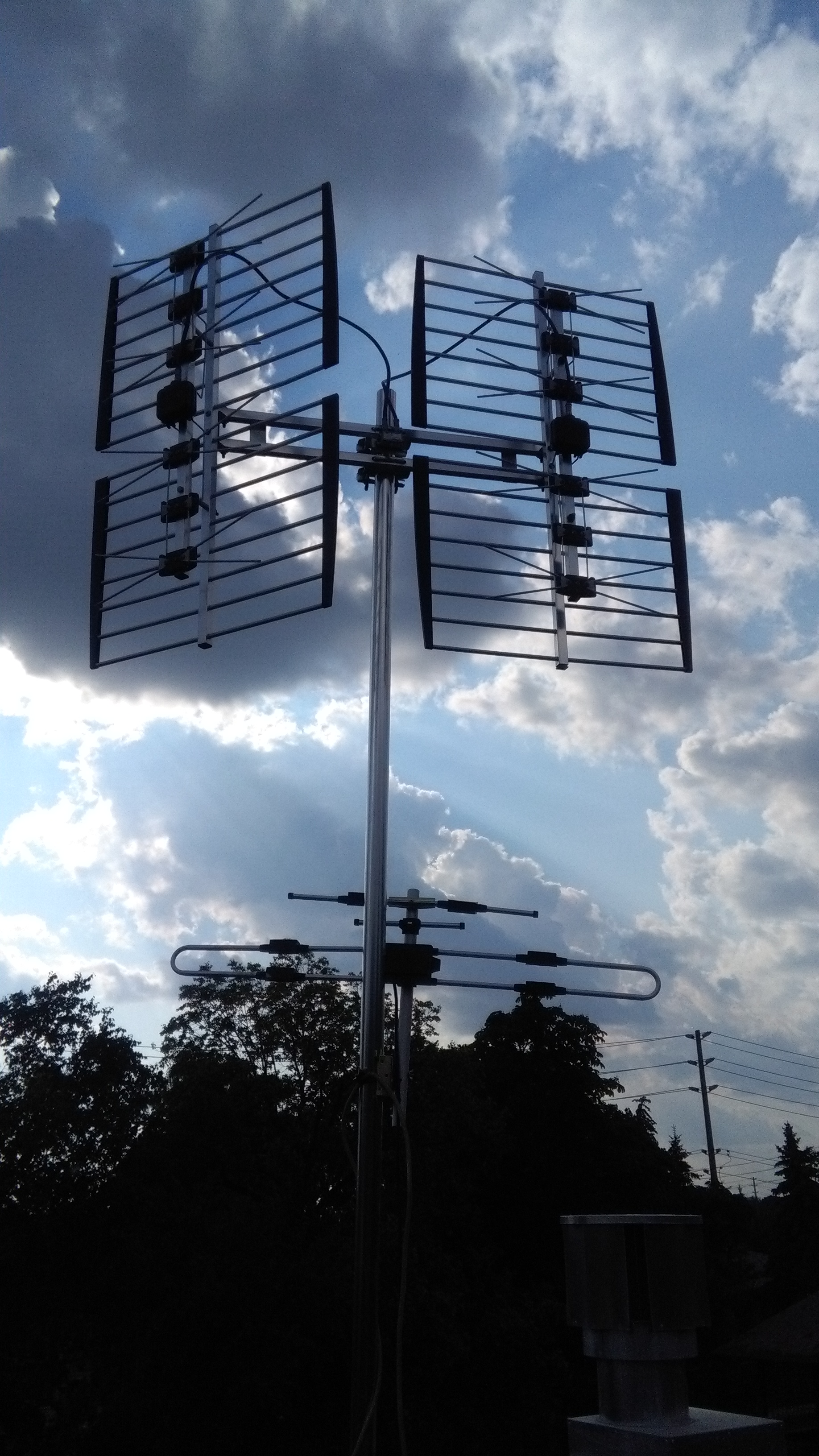

I am located in Toronto, with a clear view of the CN tower, and not far from Lake ontario. I have an 8 bay inFocus antenna roof mounted on my bungalow, with a 7’ extension on a j-pipe.
