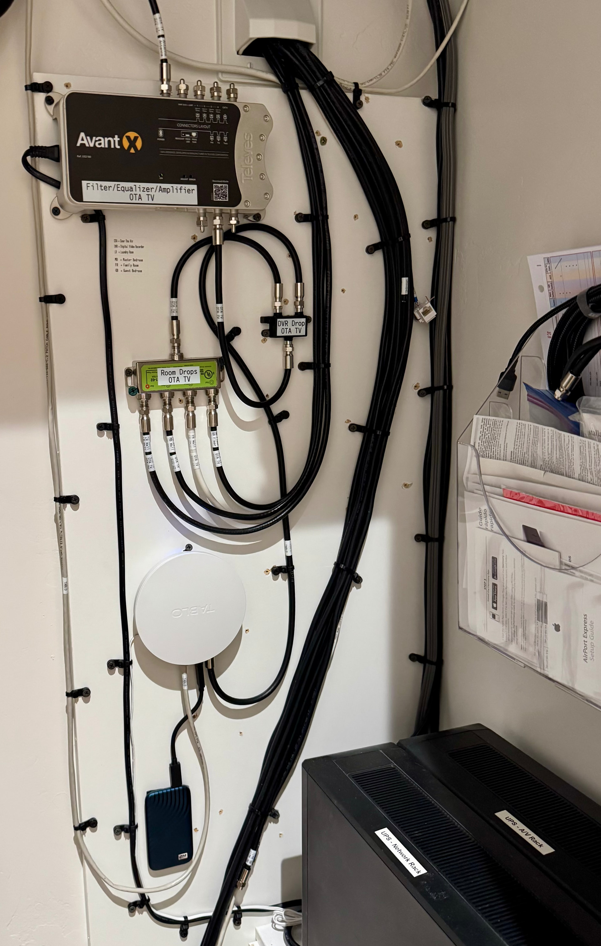

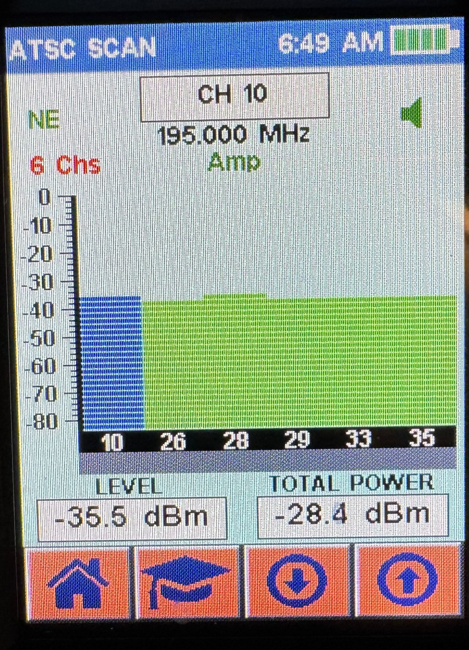

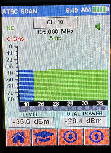

Here are the 6 RF transmitters I send to my Tablo and 4 TVs via coax. The transmitter on RF channel 10 (Hi VHF) is highlighted in blue on the meter at -35.5dBm. The other 5 transmitters are on UHF RF channels and are pretty close to that same level. These 6 transmitters cover about 30-ish virtual channels in my area. There are more transmitters available but I filter them out (don’t want them in my channel scans). I actually only use ABC, NBC, CBS, FOX, CW, and PBS. I skip the rest of the “junk” virtual channels after the channel scans in the various TVs and Tablo device settings.

Some Televes antennas feature a a close-coupled amp (BOSS) that automatically adjusts gain for both VHF and UHF bands independently and continuously. This is a step in the right direction, and is very effective for situations where the signal levels on one band are uniformly different than the other. Sort of a 2-band equalizer.
However, in situations where RF channel levels within bands vary dramatically, you still have to use other approaches (like I suggested previously) to balance things out. I happen to use the Televes Avantx digital processor which is on the high end ($400) of ways to have significant control over the RF side of OTA TV. The Televes Smartkom is $100 less and essentially has the same capability of digital RF filtering/balancing (32 user-assignable filters).
Both of these devices are very effective tools to solve specific problems. They are also expensive. (Both can also properly combine coax feeds from multiple antennas).
