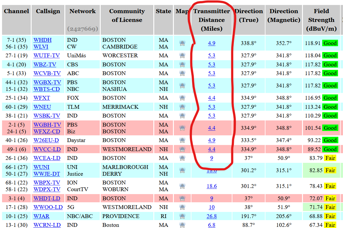

I don’t know if you’ve contacted Tablo Support, but upon reviewing what I think is your location, you may be too close to the towers. Make sure you turn off the Tablo Amplifier in the settings and review this Tablo article.

That makes sense, @sktn77a, that the antenna is outside or below the transmission cone and the amp IS needed. It could also be that the broadcast antenna was somehow adjusted or changed.
Or, as the OP said, maybe it is the Tablo and its amp was cycled on or off during an update.
The distance estimate the OP provided (15 miles) is probably much more accurate than what I posted - I just used the Dedham town center.

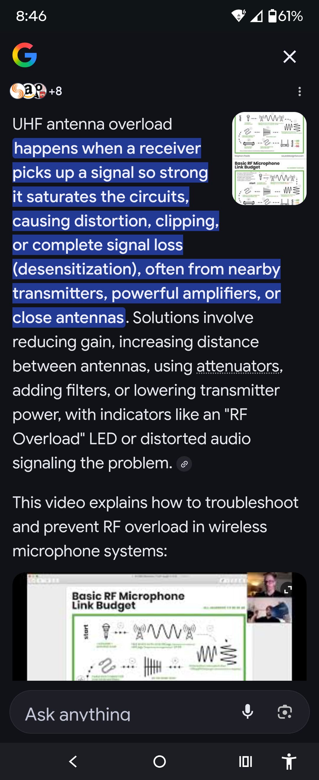

2 or 4 tuner Tablo? A 4 tuner Tablo has 6-7 dB of losses due to splitters needed to feed each of the four receivers, This is one reason why there is a built in amplifier, to counteract those losses. Did you use the identical antenna setup for TV and Tablo, antenna mounting and aiming the same (ie identical) ? Antenna feed wire identical (length type termination)? Also, as others have stated the signal might be too strong and saturating the input of the tuners. That can be fixed with a simple attenuator.

Typical NTSC 1.0 tuners can generally handle higher input signal levels than amplifiers. Feeding the Tablo with an amplified input signal will more likely overdrive the internal Tablo amplifier before it ever reaches the Tablo tuners. The end result is the same, which is why sometimes turning off the Tablo internal amp leads to “better reception”.
Actually if Fox 25 is that close and is a full power station, you may want to reposition your antenna off a few degrees left or right to reduce the chance of overwhelming the antenna.
If there is a nearby building you can aim for that to pickup the reflection.
The tuner in the Tablo Gen4 is not on-par with what you might have in the TV.
Or acquire an attenuator.
