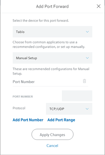

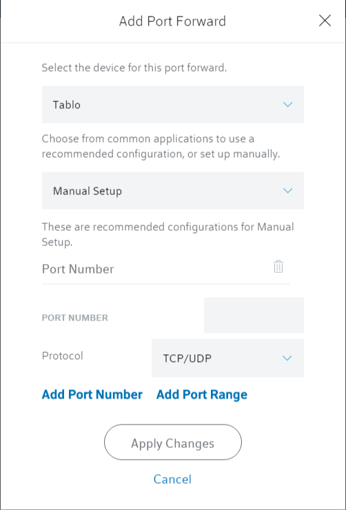

Using the Xfi portal, I can access the port forwarding area, locate my Tablo and then enter the area for manual configuration.
However, the entry form UI is totally confusing (a very poorly designed UI). It doesn’t seem to have the notion of public-to-private – only fields for port #. I tried entering 21101 in the first field called Port Number. Then, clicking on the Add Port Number link, I got another port number field where I added 8887. I repeated this process with 21100 and 80. The result just looked like it was going to forward all 4 of those ports to my Tablo. After doing that, I tried to ‘retest the mapping’ in Tablo settings but no dice.
I tried searching for help but all it really says is to enter your ports. Something tells me that I could open 21101 and 21100 and direct that toward Tablo. However, I don’t know how to get that to resolve to 8887 and 80, respectively.
