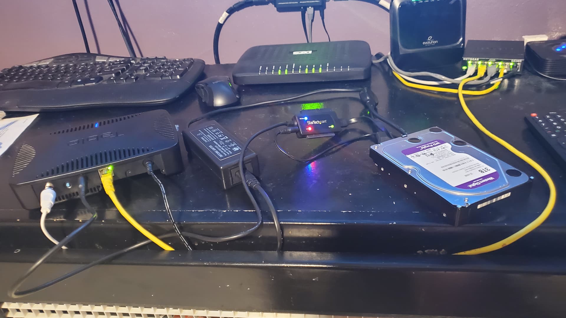

I just wanted to come back in here for what I guess is my final update. Everyone has been very helpful and I greatly appreciate all of you. You all helping me troubleshoot reminded me of a connection device I bought a long time ago. It’s not pretty but it works for now. It would have been a lot easier If the tablo had been able to supply enough power to the hard drive.

Maybe my cable is defective than. I would much rather have a direct connection like in my original photo. I will call tablo today and talk to them about how I have it set up. Thank you for letting me know most other people don’t have a problem getting sufficient power from the tablo to the hard drive.
The SATA power is only enough for a 2.5" drive. You’re using a 3.5" drive and that will require external power.
Thank you. That explains why the 2 tests with external power worked
to clarify, using a 2.5" drive. I have a 2.5" in an USB enclosure powered from Tablo Dual. I have a 2.5" internally in a Tablo Quad. I have had a 3.5" in an enclosure - which had it’s own power supply connected to a Tablo at one time.
