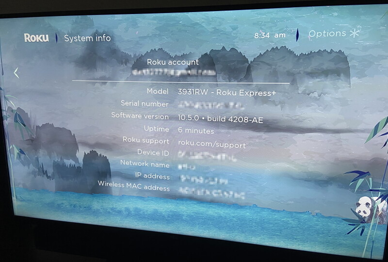

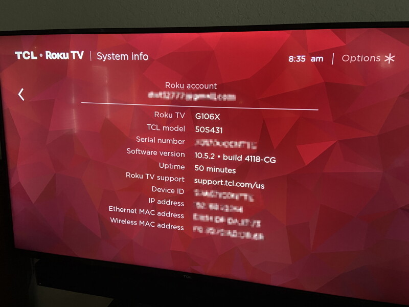

For what it’s worth, here’s another test I just performed: I wanted to see if the problem persisted with an external roku unit compared to the internal roku unit on the same TV. I plugged in a Roku Express to an HDMI port on the TV and switched to that input and went through the same steps I showed in my previously mentioned video. The problems did NOT occur using the external roku unit.
The attached screenshots show you the specifics on the internal roku model vs. the external roku model.
Our team has taken a look, and it seems clear these are some kind of rendering issues coming from either the RokuTV’s hardware or software - this definitely seems to be the case since bypassing the Roku TV itself solves the problem.
We don’t believe there’s anything we can do from our end to resolve this, but if we do manage to reproduce this internally we’ll share the details with Roku.
