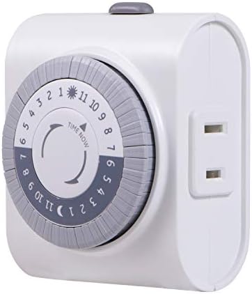

…or put one of these on Tablo set to power off for 15 minutes at some time in the night.
