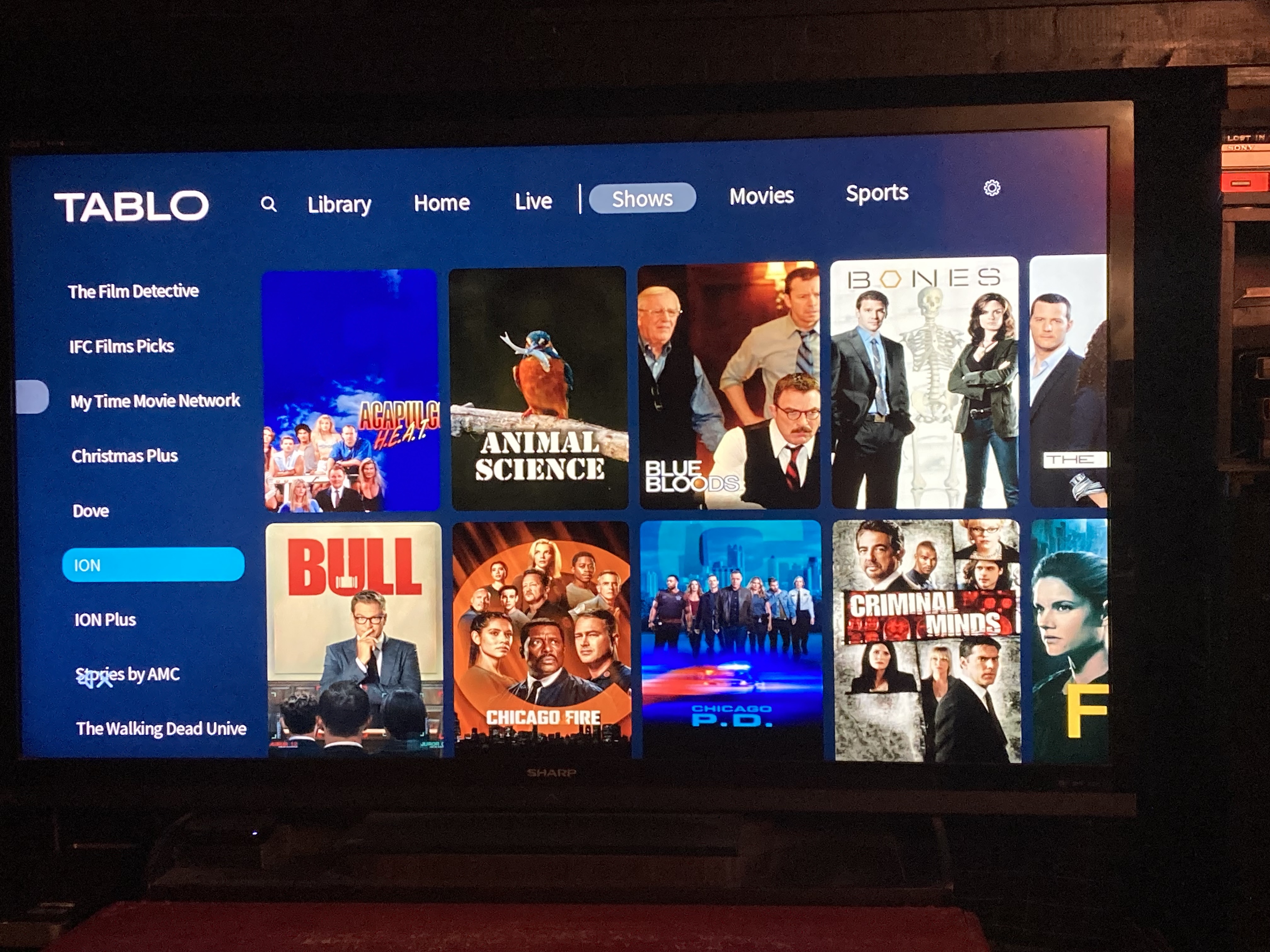

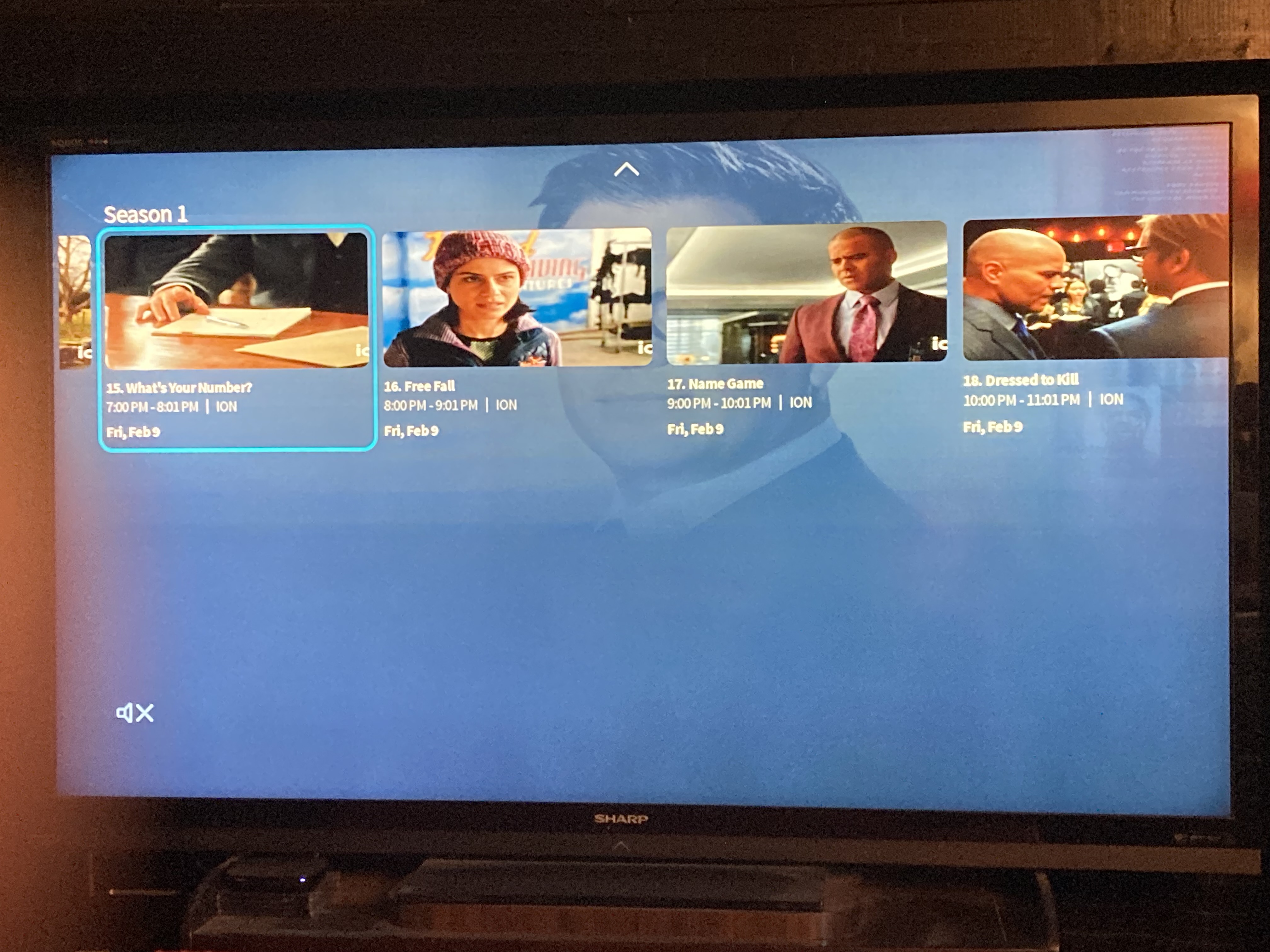

I just noticed the recording of the series BULL SOMETIMES defaults to the streaming FAST channel ION rather than the OTA channel ION 54.1. Perhaps that might explain the timing error.
Question: any way to force recordings only on OTA rather than FAST or vice-versa? I can tell the broadcast channel resolution for OTA signals, but how can I tell the channel resolution of a FAST broadcast which may be lower resolution than OTA?
Also, many ISP have streaming limits, which would be another reason to prefer an OTA broadcast over a FAST broadcast for the same movie.
Recorded FAST ION:
Recorded OTA ION 54.1
