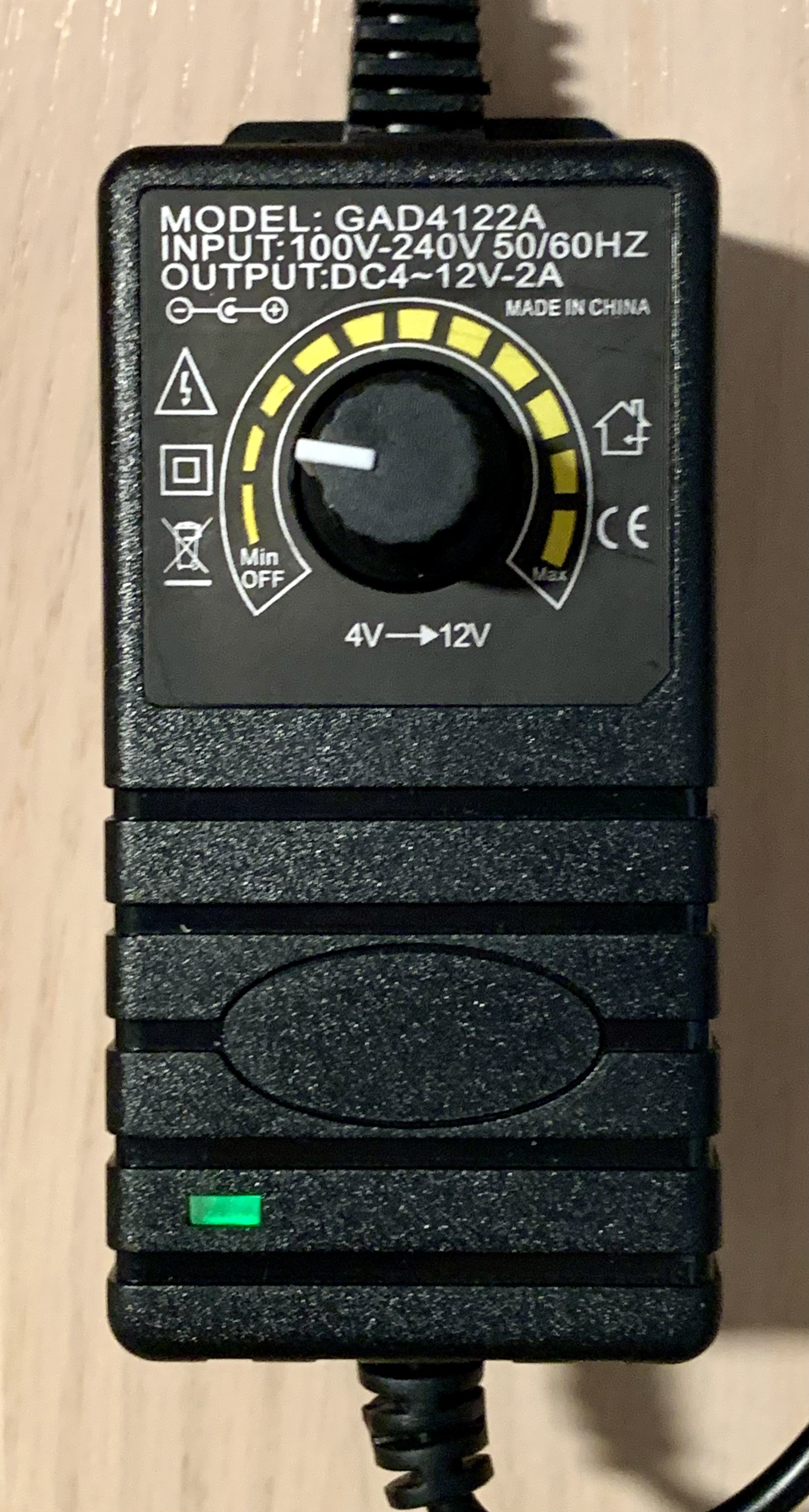

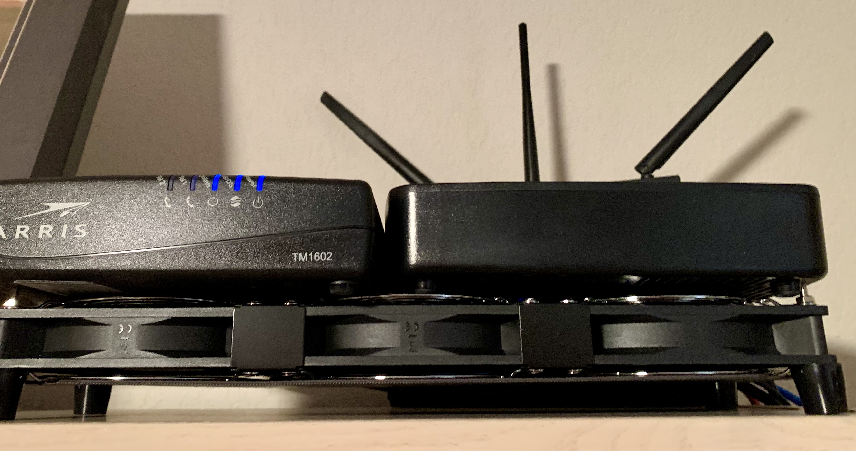

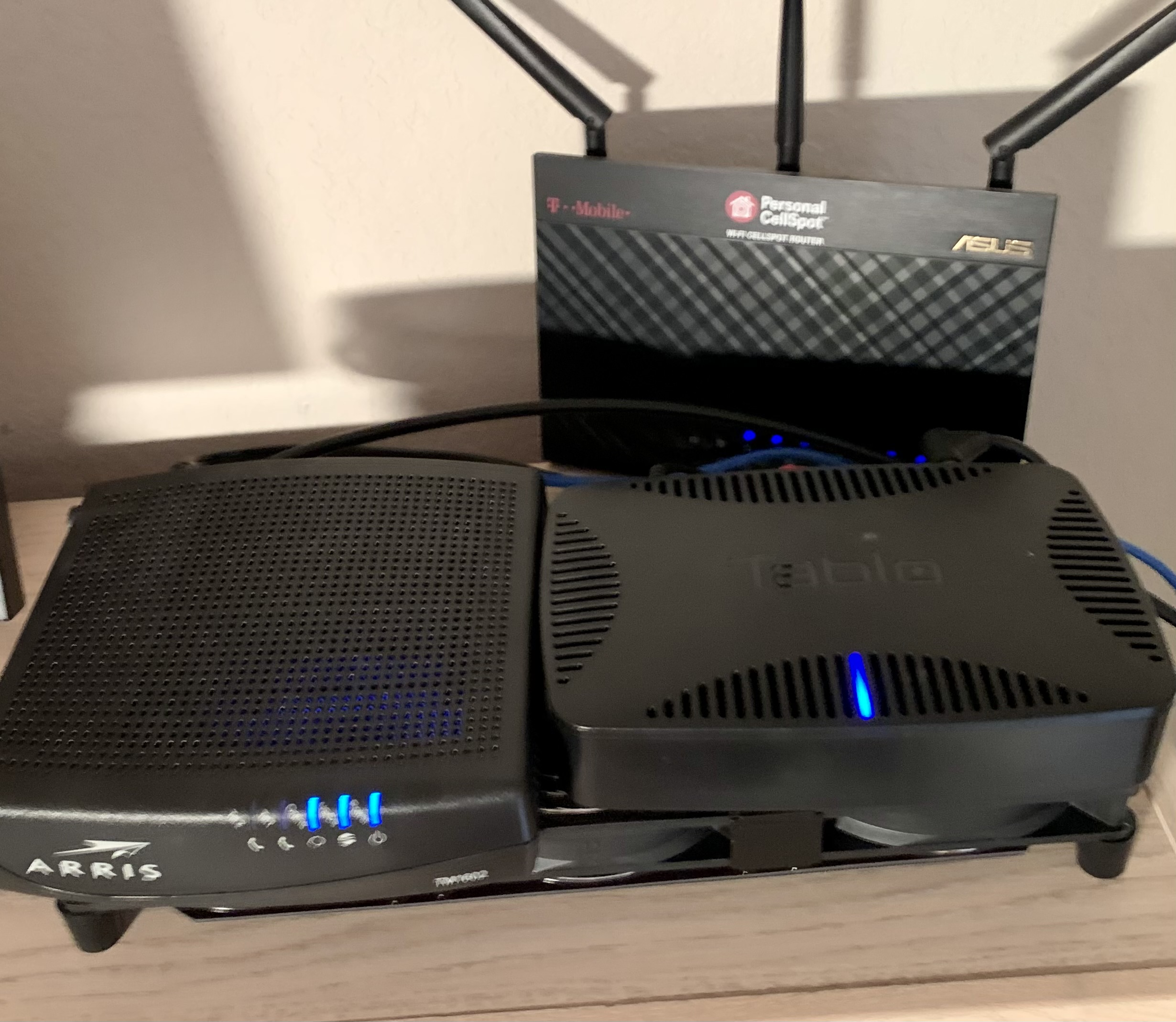

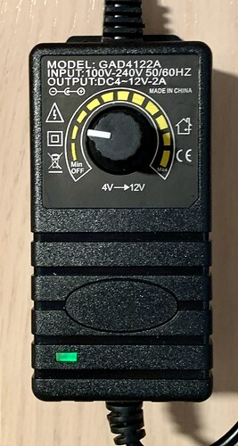

I decided to try some cooling fans as I thought this would if anything help with longevity of the internal hard drive and the Tablo itself. Within a couple minutes of setting the Tablo on top of the fans set half speed I took the temps in the same 5 places and they ranged from 84° to 89°F. I decided to see how low I could turn the fan speed down before the temperature started to creep up and settled in at 1/4 on from the off position. When I place my hand on top of the unit, I can still feel air flowing up through it. I do have a magnetic filter on the underside of the fans.
It’s been 3 weeks since I have been running the fans and I have only had to do a soft reset twice. This is a great improvement compared to what I was experiencing for the previous 2 months!
