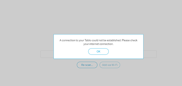

I have been having issues with the Tablo maintaining connection to the web app. When trying to connect from the web based app, I get “A connection to your Tablo could not be established. Please check your internet connection.”. I know that the internet is fine on my computer as I can surf the web and connect to my router by entering its IP (192.168.2.1). After rebooting the Tablo, it works temporarily on all my devices, but then after a few hours the web based clients can no longer connect. In trying to resolve the error, I came across forums suggesting to assign the relevant computers and the tablo static IP addresses, so I did that.

This is a new tablo. I have just had it for a week. I understand that the only way the Tablo will actually work with my computer is via the web app. I am just using the manual IP address entry as a way to prove that the router is actually correctly transmitting traffic between my computer and the Tablo. This is what happens when I use the app.
Also if I press the red x and try refind the tablo I get this until power cycle the Tablo
