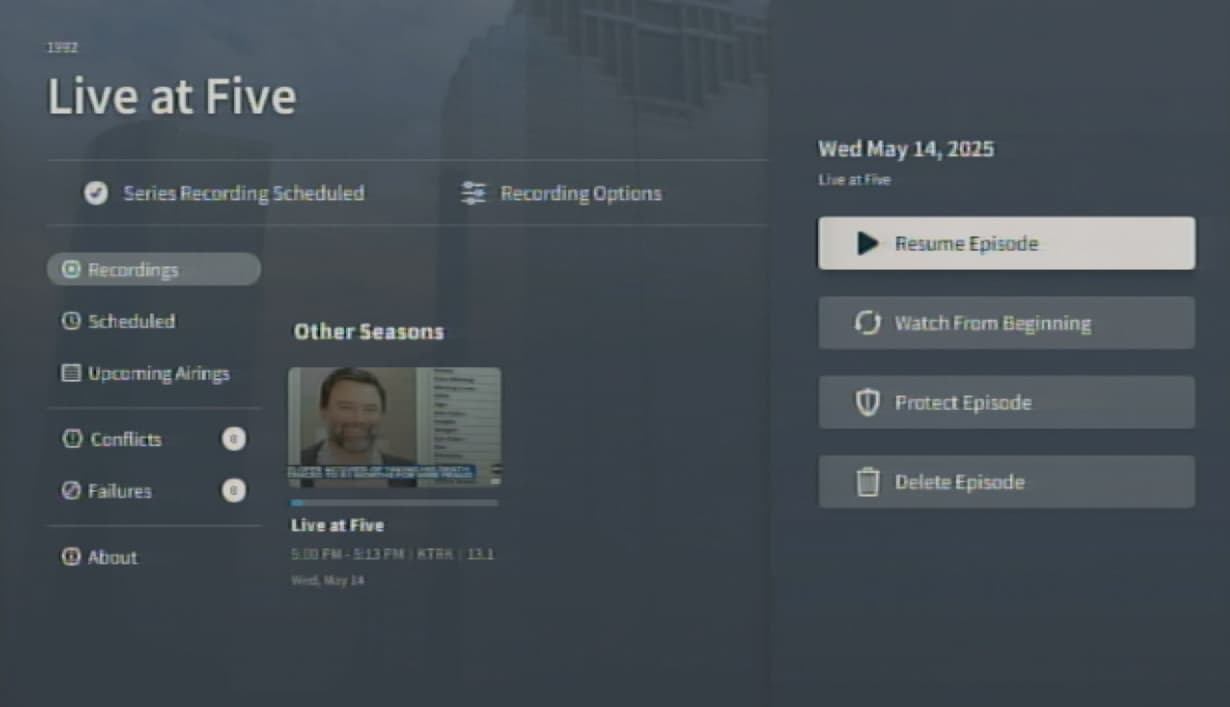

Interesting new observation. Today, while my Tablo 4th Gen Quad was recording ABC World News on ABC affiliate KTRK 13.1 from 5:30 to 6:00pm, I also had the immediately following half-hour local news programmed on the same channel, with its recording starting 10 minutes early. So two of the four tuners were on channel 13.1 simultaneously, recording the exact same content for 10 minutes (5:50 to 6:00 pm).
The 1st tuner recorded just fine. The 2nd tuner had the same video-delayed sync issue that continues to plague all of the Tablo 4th Gen products that I’ve used here in Houston. Two tuners, both 5:50 to 6:00 pm, one good recording, the other bad. Go figure.
As usual, my AirTV Anywhere, recording the same indoor antenna signal off a splitter, played back both recordings just fine. That product never fails.
