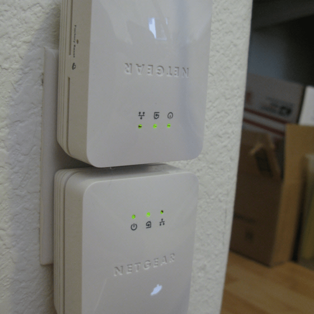

Have you considered Powerlind Ethernet Adapters?
What are Powerline Ethernet Adapters and How Do They Work?
Powerline Ethernet adapters are hardware technology that enable you to extend hardwired Ethernet connections to places in your home where you may not have an Ethernet jack installed or where WiFi reception is poor or unavailable.
The adapters plug directly into your home’s power outlets to deliver Ethernet traffic over your home’s electrical system. Kits cost between $30-$80 US.
I haven’t used them, they have been discussed by other users here at Tablo Community forum.
