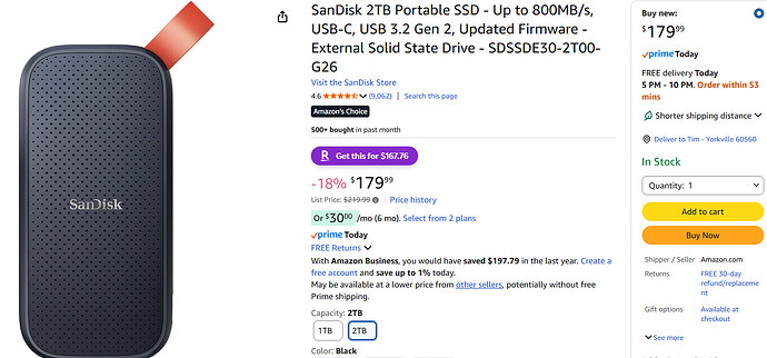

Gen 4 - does something like the Seagate work well without data errors and issues, for example STGX2000400
And since motors and spinning things can DIE, use more power and take more space is anyone using a SSD hard drive for the Gen 4? I’ve had drives stop spinning and head errors and so on in the past with hard drives - though the 2T Seagate on my Legacy is 10 years old and works GREAT to this day! Shock.

Although, there is some evidence now that suggests that for the constant rewrites that a device like the Tablo does, an HDD is longer lasting than an SSD, and are now notably less expensive.

Just stick with a new, name brand HDD (not SSD) and you will be fine.

That’s the first thing I found after doing a search but wondered if there were things to avoid, if people used SSDs and so on. But after looking at price differences, I decided against SSD and just stuck with one like I have on my legacy Tablo - a Seagate 2T USB drive. Inexpensive and what Tablo recommends on that page you linked - guess I can’t go wrong.

My understanding is that SSD drives are not recommended for this use, and that’s good enough for me…
