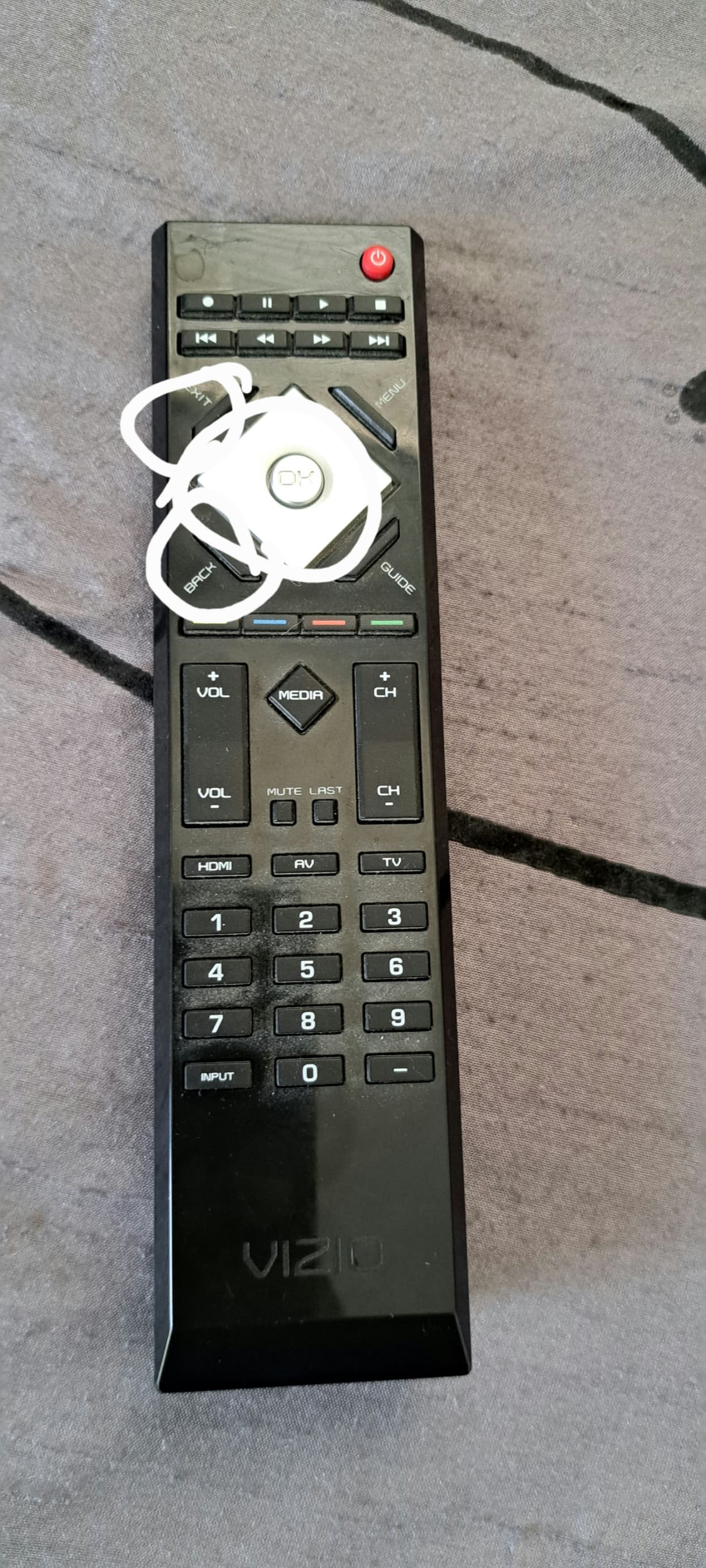

Just tried with my Vizio remote and it does works, this is my remote and the areas with the white circles are the ones I use to control the Tablo
