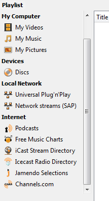

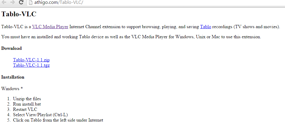

VLC downloaded and installed but could only open the .zip file for Tablo-VLC (What is .tgz anyway?) And when I double click install just get a quick pop up box that disappears just as quick. And when I open VLC I do not see Tablo under internet. Any suggestions?

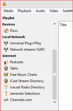

Maximize VLC and hit control-L. You should see Tablo on the left list. Click on Tablo and select a movie then Play.
The install.bat file does not show a response when launched from the Desktop. It does if launched in a Dos window. It requires a restart of the V L C program.

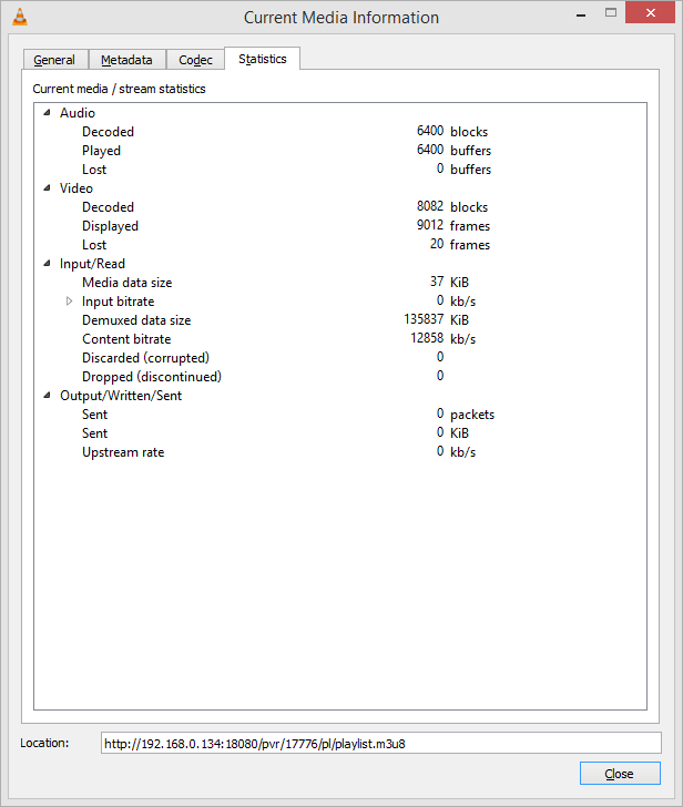

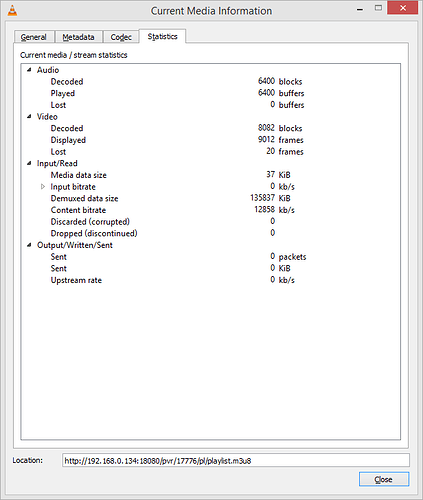

Tablo-VLC gives statistics while playing the files.

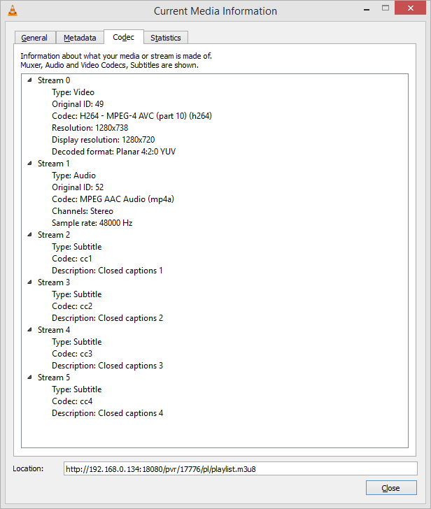

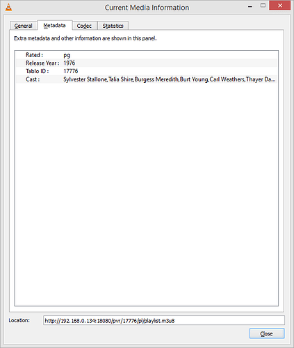

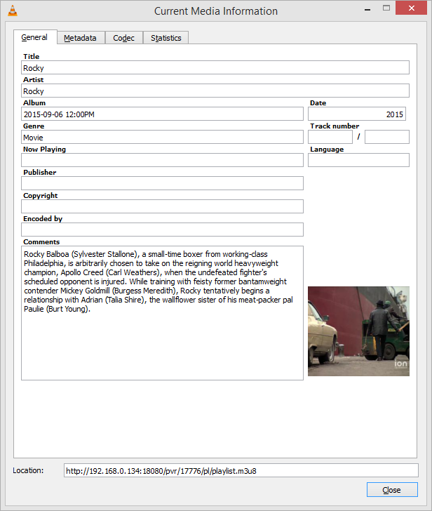

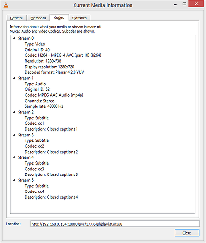

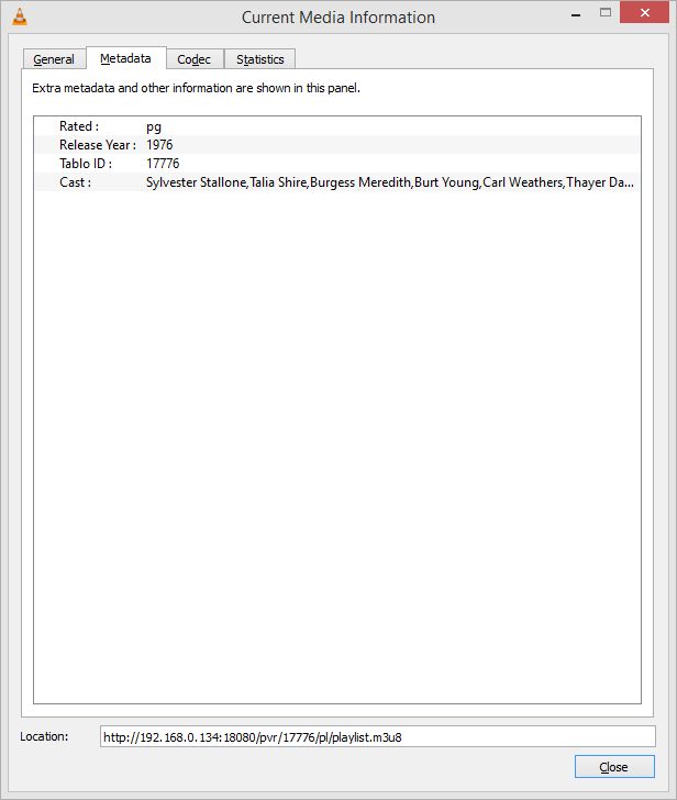

Here are screenshots while I played the movie ROCKY on my PC; station transmitted 720P; recorded at 1080P with firmware 2.2.2. After about 3 minutes into the file:

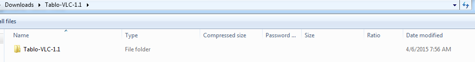

Yeah something usually happens when you unzip a file but not here. I just gave up. The point of the post was for Tablo folks to hear of it and get some ideas (from Tablo and Community) of troubleshooting existing set up that should work without effort and did up until recently.

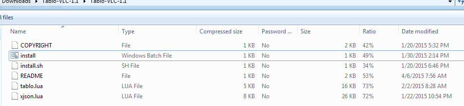

I mean I don’t think that this is the type of file that you can execute from within the zipped file. It sounds like you are double clicking the zip file which is opening it up for you to view the contents, but that isn’t the same as actually extracting the contents and then running the executable file. Make sure that you are actually extracting the contents into a folder before you try running the executable file.
I agree but nothing opened to allow me to extract the file. Since it wasn’t as obvious as I’m thinking it should have been I just gave up. It’s not part of Tablo anyway but it was a good thought! I’m more in the camp of “Tablo should work by itself”.
You should be able to run the batch file as an administrator by right clicking and if it doesn’t give run as admin as an option look under Properties then compatibility.
Ok…so here is what I see. Right clicking on any of these does not provide any kind of administrator option. If I right click and open Properties I get tabs with General, Security, Details, Previous Versions. I also don’t see compatibility anywhere either. Really, not a big deal.
