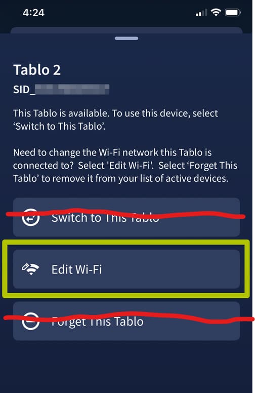

First, the biggest trouble was trying to clear the old wifi on the Tablo and use Ethernet. I still don’t know whether it’s working on wifi or Ethernet as I didn’t have access to their router to check.
One painful item is clearing the wifi to switch to Ethernet. We tried to follow these instructions and these instructions, but they just didn’t work. Mainly, there was no button to Forget This Tablo or Switch to This Tablo. Only the Edit Wi-Fi button was available. When trying to edit the wifi, it just wouldn’t connect, even though the Tablo and iPhone were right next to the router.

I eventually performed a factory reset on their unit hoping this would clear the wifi. I’m not convinced that this worked, but we eventually got it connected, hopefully on Ethernet, and we were finally able to bring it up on the Roku. Here is where Tablo should add to their My Status page - maybe move or add some helpful functions for configuring the Tablo network to this page instead of in the app.
