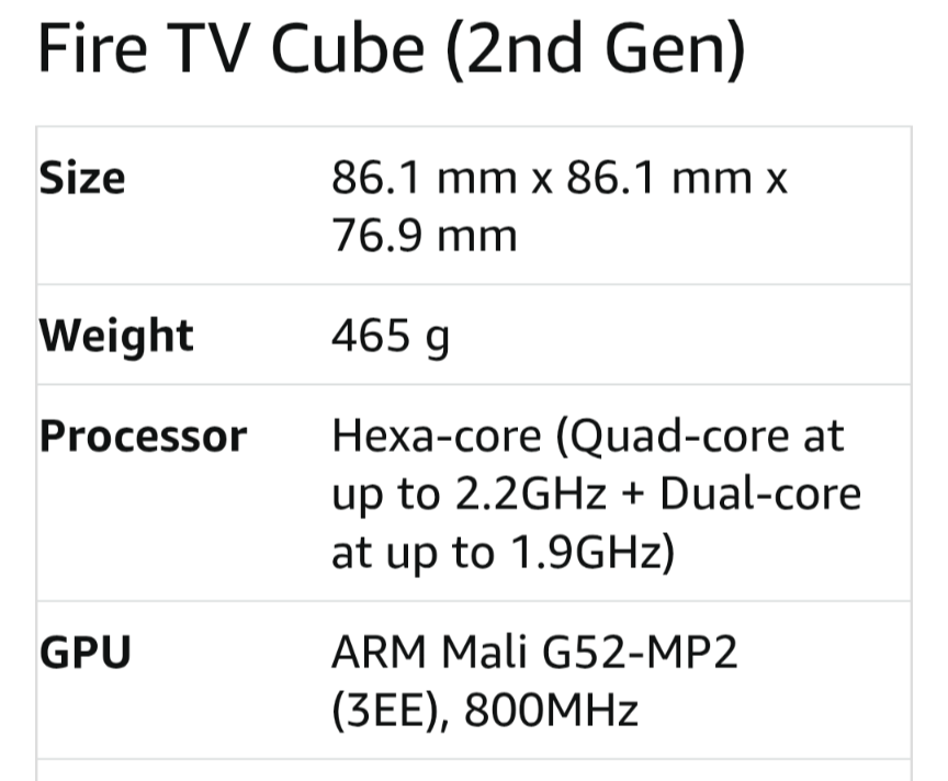

Here is a swag if it’s a gen 1 cube. The gen 1 fire tv cube used the amlogic S905Z which didn’t have mpeg 2 hardware support. It was software decode.
The four I have are all 2nd Gen
This kinda sounds like what I am currently seeing, but not seeing any comments or resolution
