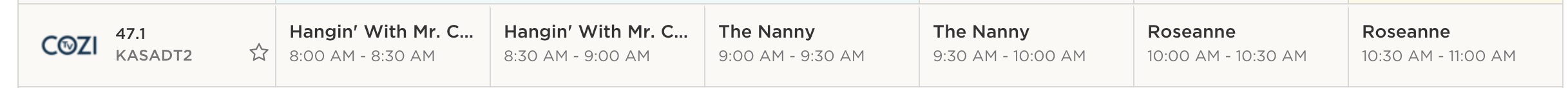

Yes. Same on iPhone, iPad, and Roku. That channel is listed ion Gracenote…
@CarbonCompound
The channel IS listed on Gracenote OTA with either zip code I tried.
Tablo finds the channel when scanning BUT the channel DOES NOT appear in the Tablo guide AFTER scanning and save on either iPhone, iPad, or Roku.

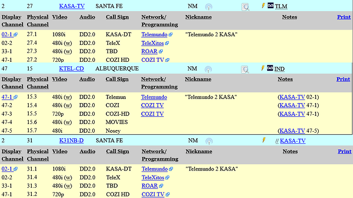

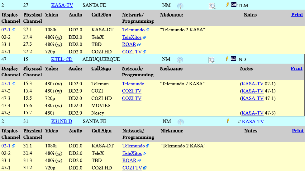

Rabbitears shows three stations using virtual channel 47.1 in zip 87015. Maybe Tablo is getting confused.

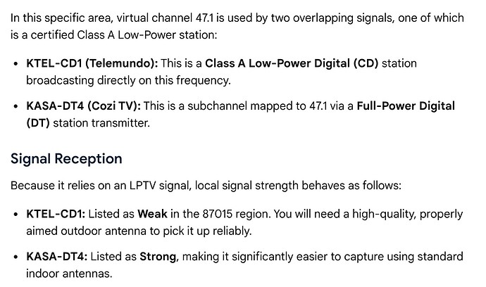

This should be an interesting response. Are you talking about a LPTV station with a signal strength of -69.
@zippy
I thought I brought this thread to an end but the only way I can answer your question is THIS…
KASADT4 47.1 listed as STRONG is the station that shows up in the Tablo channel scan but does not get saved to the Tablo guide.

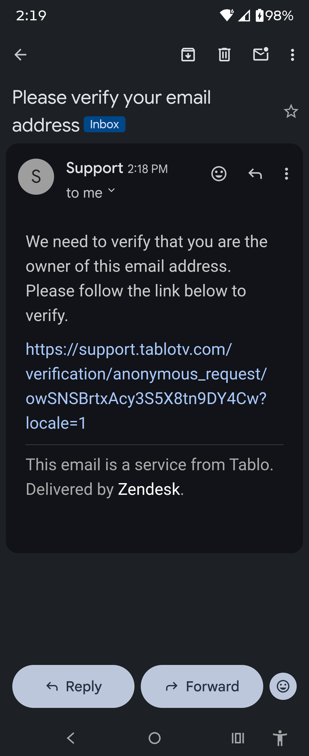

I just requested that KASA 47.1 be added to the Guide Service.
