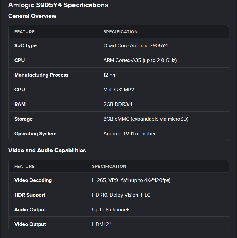

In reviewing the specs on that chip, it looks like it doesn’t support H.262/MPEG-2 or H.264/MPEG-4 for video decoding.

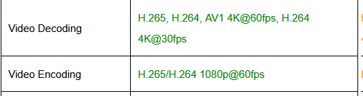

Although, this set of specs shows slightly different results, which is still problematic for H.262/MPEG-2:
