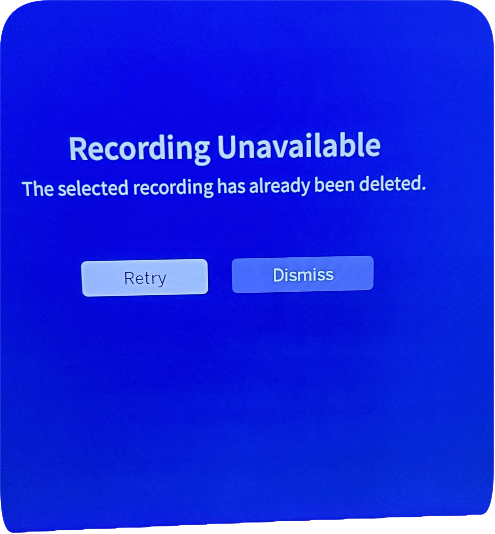

Record Unavailable when watching live tv
Live tv stops many times and I get this message
“Recording Unavailable”
"The selected recording has already been deleted "
2 option buttons appear
“Retry” and “Dismiss”
When I’m watching live tv on Tablo, this message appearing and pausing live tv is bizarre! How do I fix this?

4th gen, on amazon fire tv. I’m not recording anything when this happens. Maybe weather or airplane disturbance related. The wording of the message does not relate to the problem and the action to try again repeatedly is annoying.
@friedfarmer ,
We’ve dicussed this with the product team. They’d like to see some screenshots.

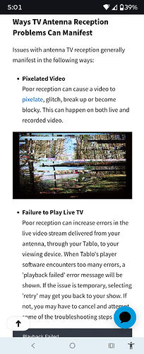

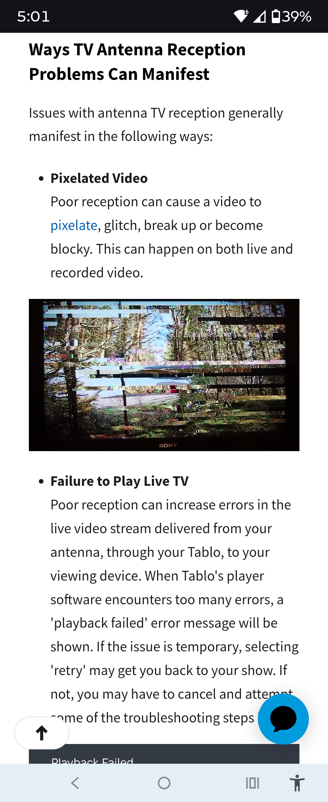

I’ve seen that error several times. It’s not a weak signal but pixilated or when signal breaks up repeatedly.
The message is kinda misleading but I have 'back’ed out and retried sometimes that works.
Usually I don’t get to finish watching because of the errors so I watch something else.
https://support.tablotv.com/hc/en-us/articles/210429406-Troubleshooting-TV-Antenna-Reception-Issues?_gl=1*bnxz12*_gcl_au*MTQ3NDY1NjYwMy4xNzg2MjI0ODU4Li0uLS4xNzg2MjI0ODU4LjUzMzg3MDM5Ni4xNzg3Njk0OTY0LjE3ODc2OTUxNDk.*_ga*MTA0MzEwMTIyOC4xNzg2MjIwODk3*_ga_FJZJTK8CDQ*czE3ODc2OTQ5NjQkbzE1JGcxJHQxNzg3Njk1MTUzJGozMCRsMCRoMA..#h_01JPWY8F5819VYMRZ0MCK7CSBR

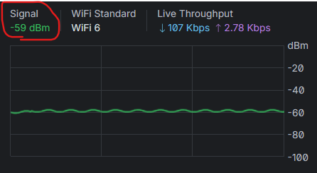

Okay, if it works on your phone, then it sounds like the network between the FireTV and router needs to be optimized/improved.
Can you run a speed test from the FireTV? Or, better yet, can you see the strength of the connection to the FireTV from the router (not all routers have this level of detail)?
