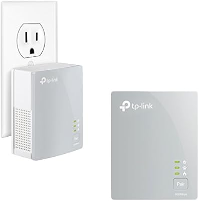

This one got good reviews not only from cnet but also from real users…and won’t break the bank —

The one I linked above is AV2 and CNET states that in it’s testing it could sustain “about 250Mbps”.
I liked that one because it was pretty small in comparison to the others…and at $40 I’m not sure I can beat it.
