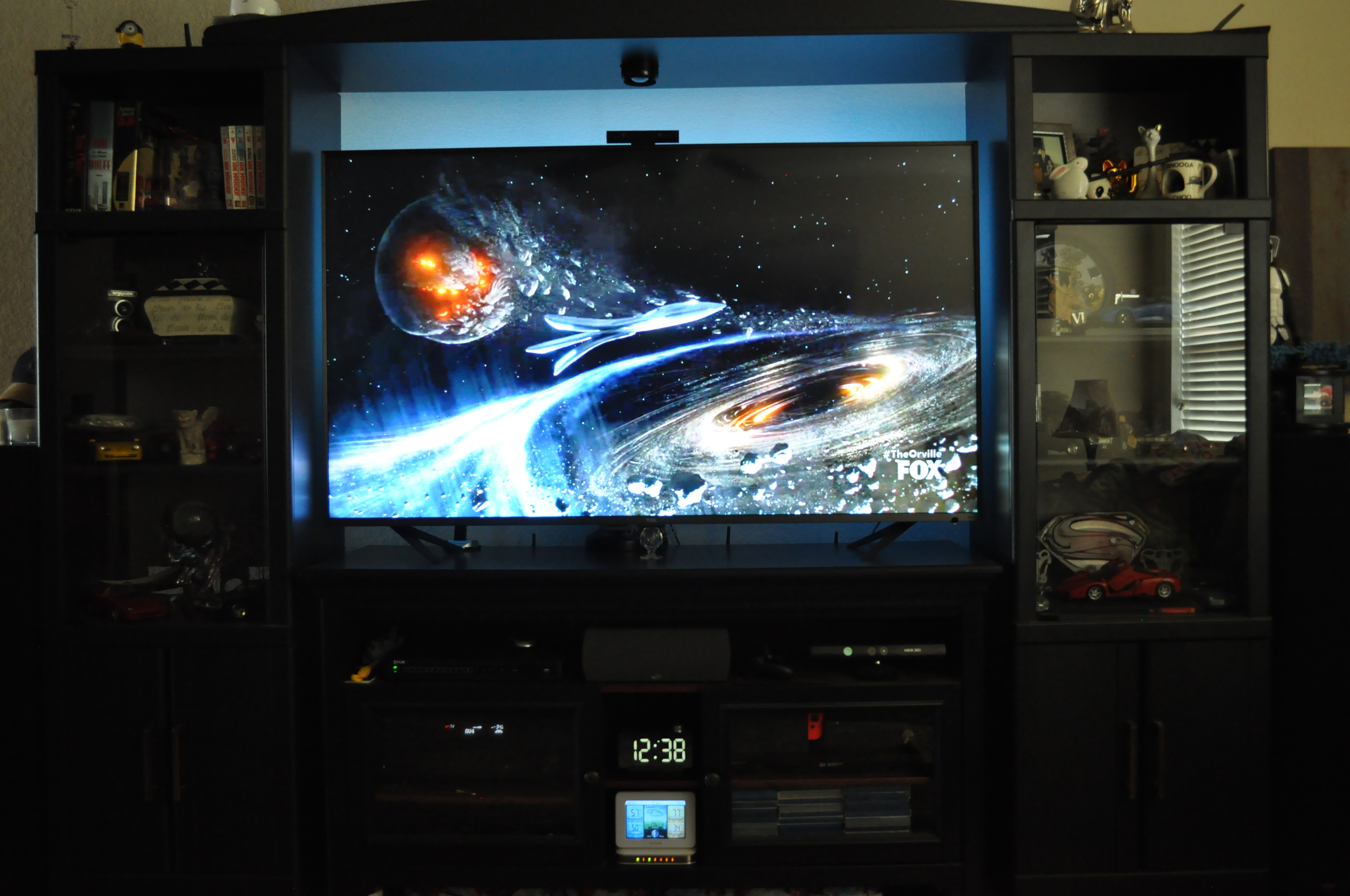

I just got the TCL 6 series with Roku from Best buy when the 65" was on sale using TABLO 4 tuners mine is hardwired too and set to highest setting on live TV no complain awesome picture it’s a bargain TV that can compete to the more expensive TV twice or more in price. Put some screen shot here my camera don’t take that a great picture but you can see
