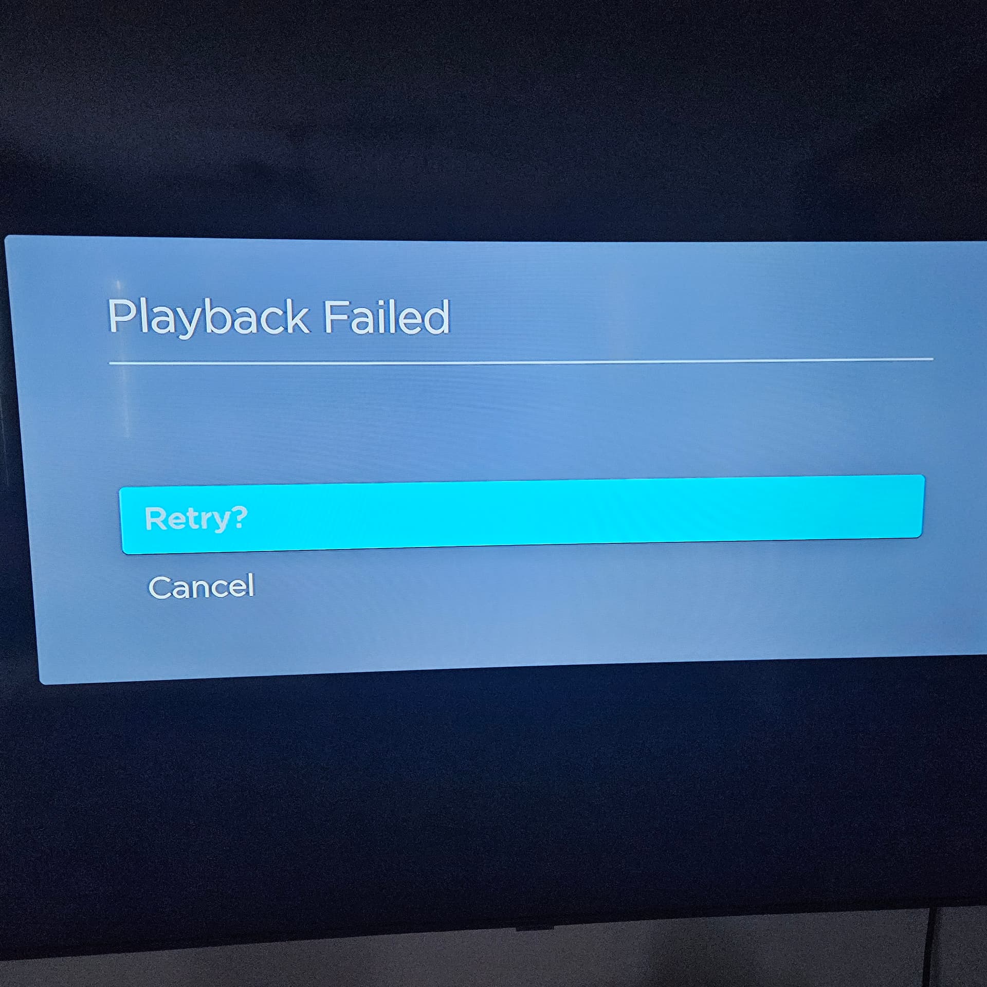

Playback failed, retry or cancel.
All of my over-the-air channels were giving the playback failed error. I finally tried unplugging my unit and letting it cool down and that did the trick.
I guess I’ll have to invest in a small fan to keep the unit cool. Tablo should consider making Gen 5 with a built-in fan. Shame the company cannot figure this out before sending it out in the market @TabloTV @TabloEngineering @TabloSupport I guess it was a lack of testing.
