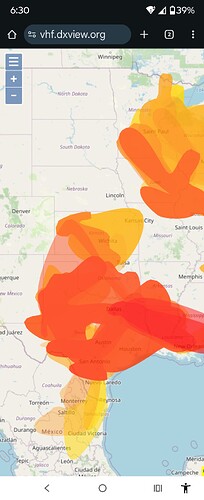

I’m able to scan and lock TV stations over 100 miles away during Tropo/weather events without changing the zip.

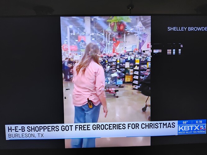

KBTX 3 (RF16) in Bryan Texas is 200 miles from Dallas.

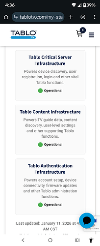

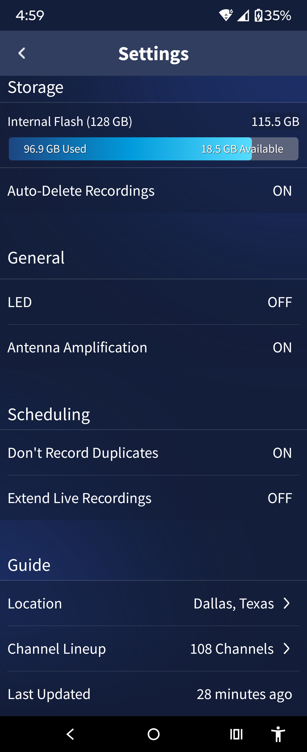

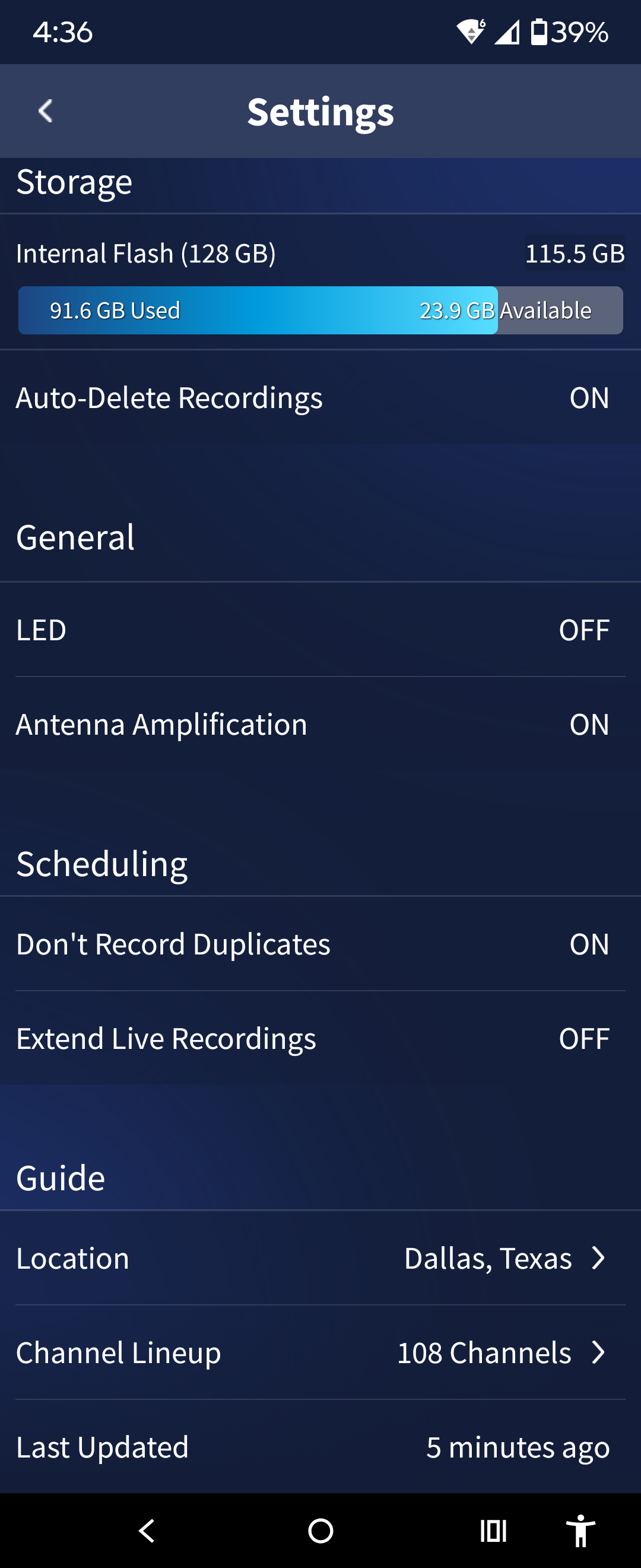

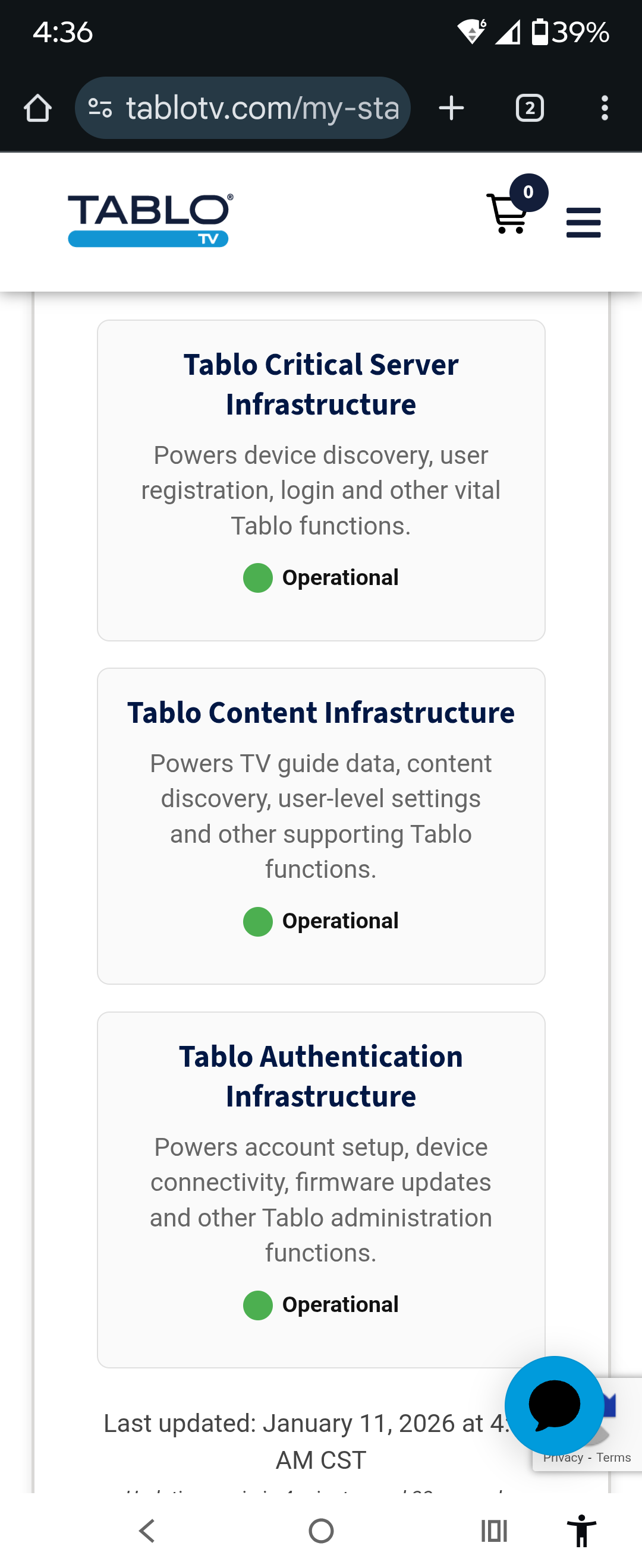

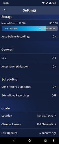

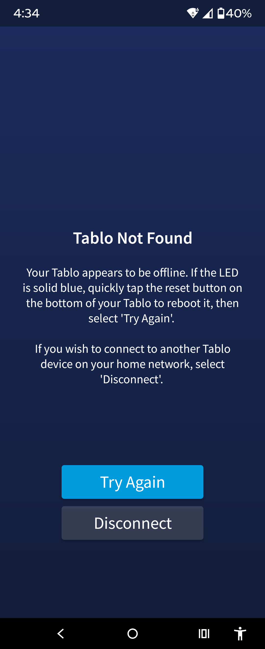

Sunday January 11, 2026 4:30 am CST.
Anytime the servers are not available you can get an error message.
The Content Infrastructure server is otherwise not available every night during the Guide Update.
Perhaps the Tablo Gen4-2 initiates the update but the result is the same. Error message during the update nightly.
With luck, the downtime is brief. I’ve seen it finish in under 5 minutes and I’ve seen it run for 12 hours.

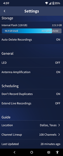

When you change zip code and rescan/save you are overlaying your database info with a complete new set of guide info.

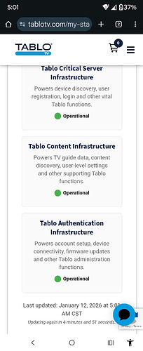

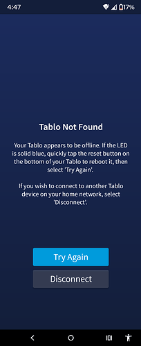

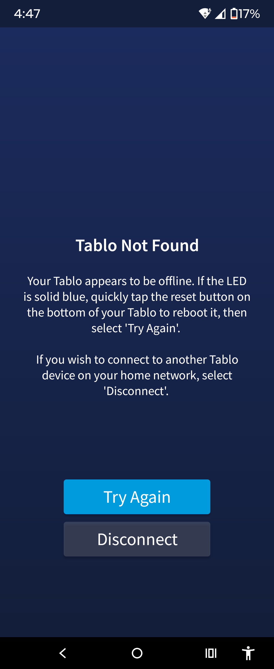

Monday January 12, 2026 4:30 am CST

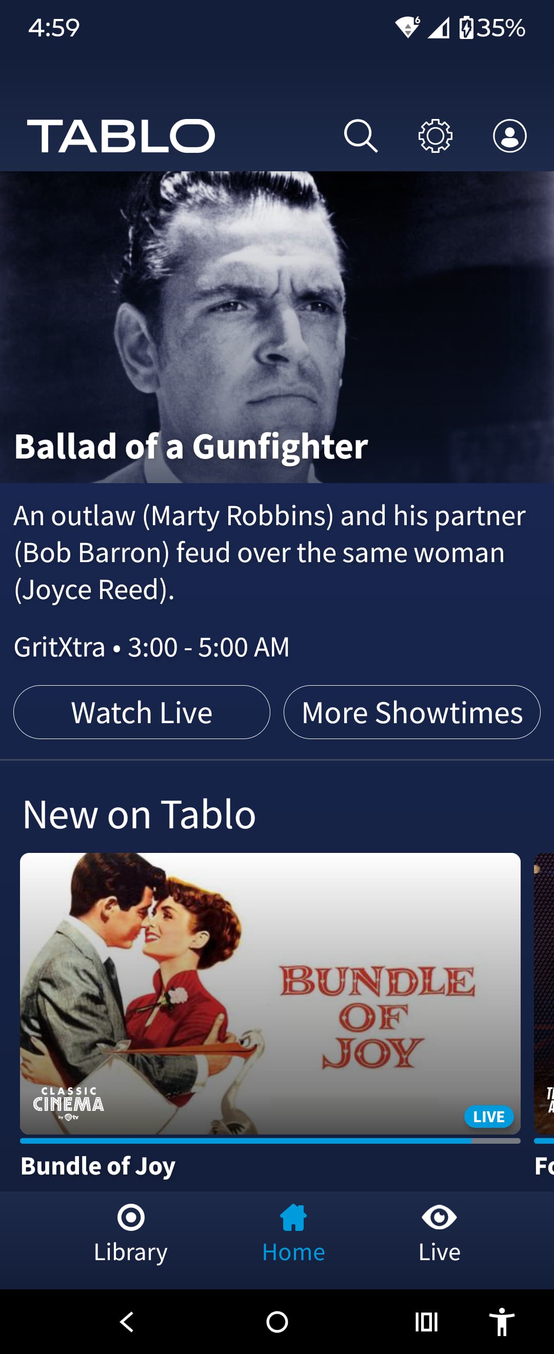

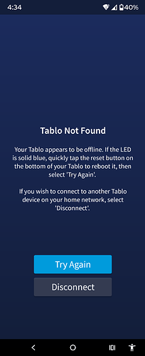

Android mobile won’t connect. LGTV indicates overnight Guide Update finished.
Had to uninstall and reinstall Android mobile app after reboot of the Tablo Gen4.
@TabloSupport Is this accurate?
