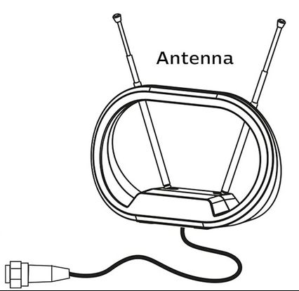

Living in a major city, I get good results with an indoor antenna. Here’s my setup:
I have enabled antenna amplification in my settings.
