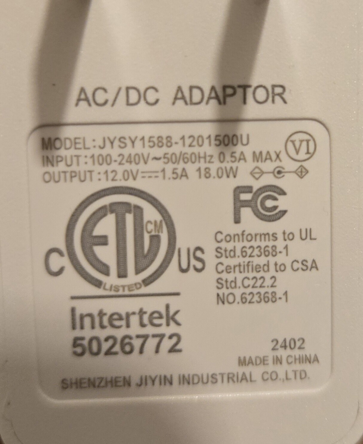

The specs should be printed on the original power supply in tiny, microscopic print. All except for the barrel size. The important numbers follow the OUTPUT tag - 12.0Volt DC, 1.5Amp, 18.0Watt

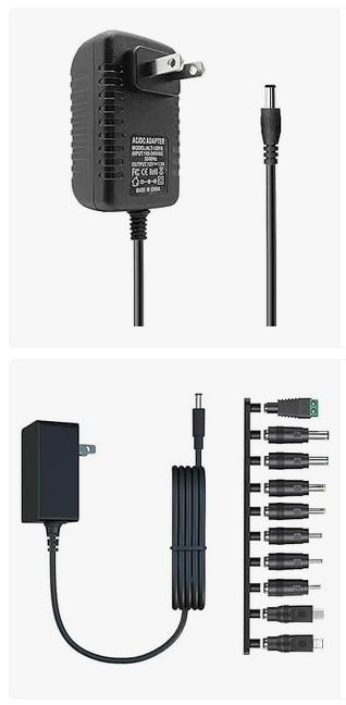

The barrel size is the size of the cylindrical plug that supplies power to the device. They come in different sizes. The Gen4 OEM Tablo power supply should be the proper fit. If you buy one on Amazon, it may not be the proper size. However, you can buy power supplies that have adapters with different sized barrel plugs, so one should fit.
The top power supply has a single barrel plug that may or may not fit. The bottom power supply comes with interchangeable barrel plug adapters.
