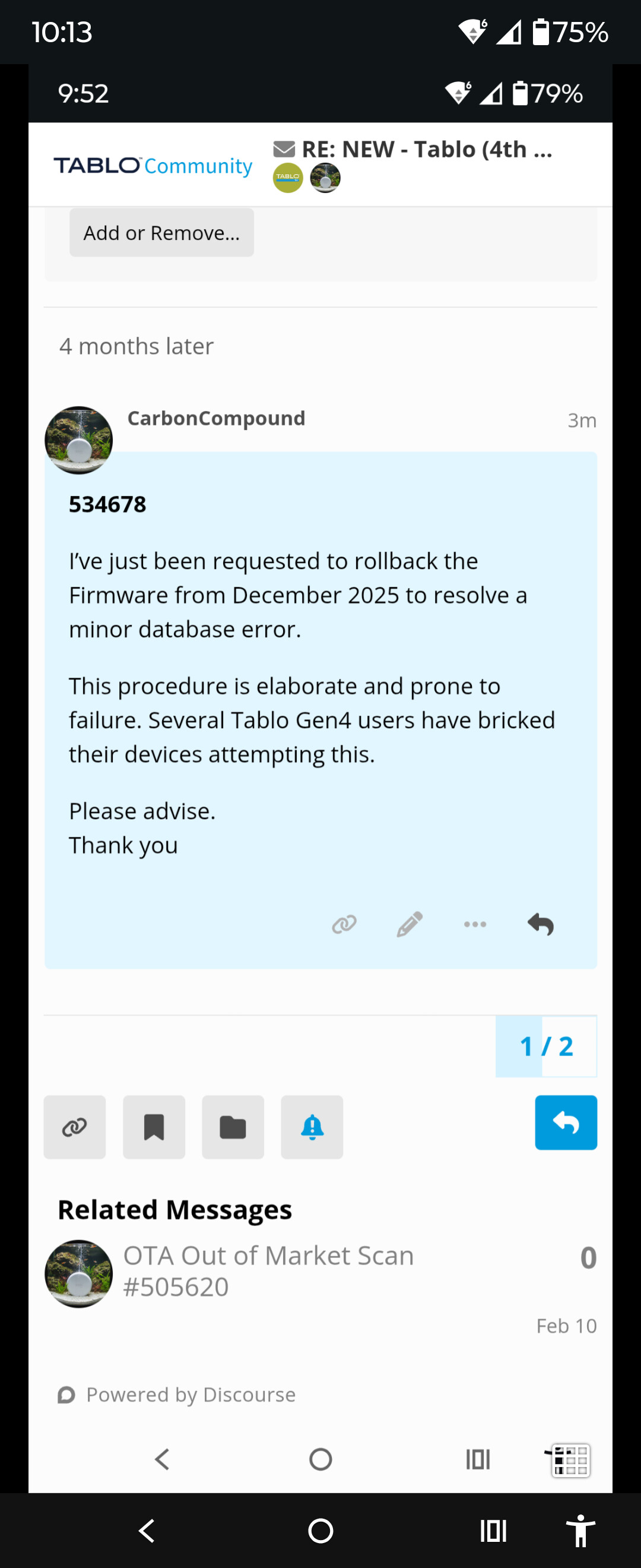

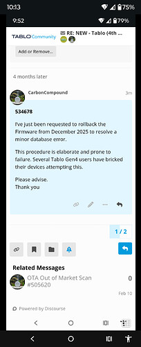

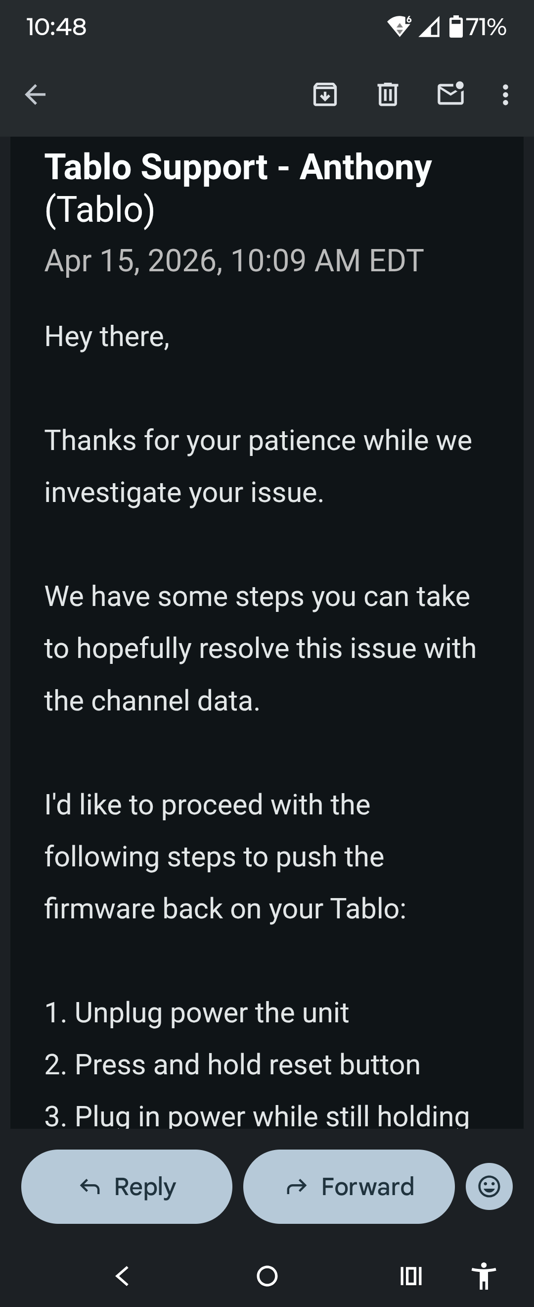

Why would the Tablo Gen4 Firmware update from December 2025 cause missing channels?
I’ve been asked by support to rollback the Firmware.
Rescans usually brought missing channels back for me. I even recall others using neighboring zip codes.
I should have thought of that before posting.
Said no one… Ever…
