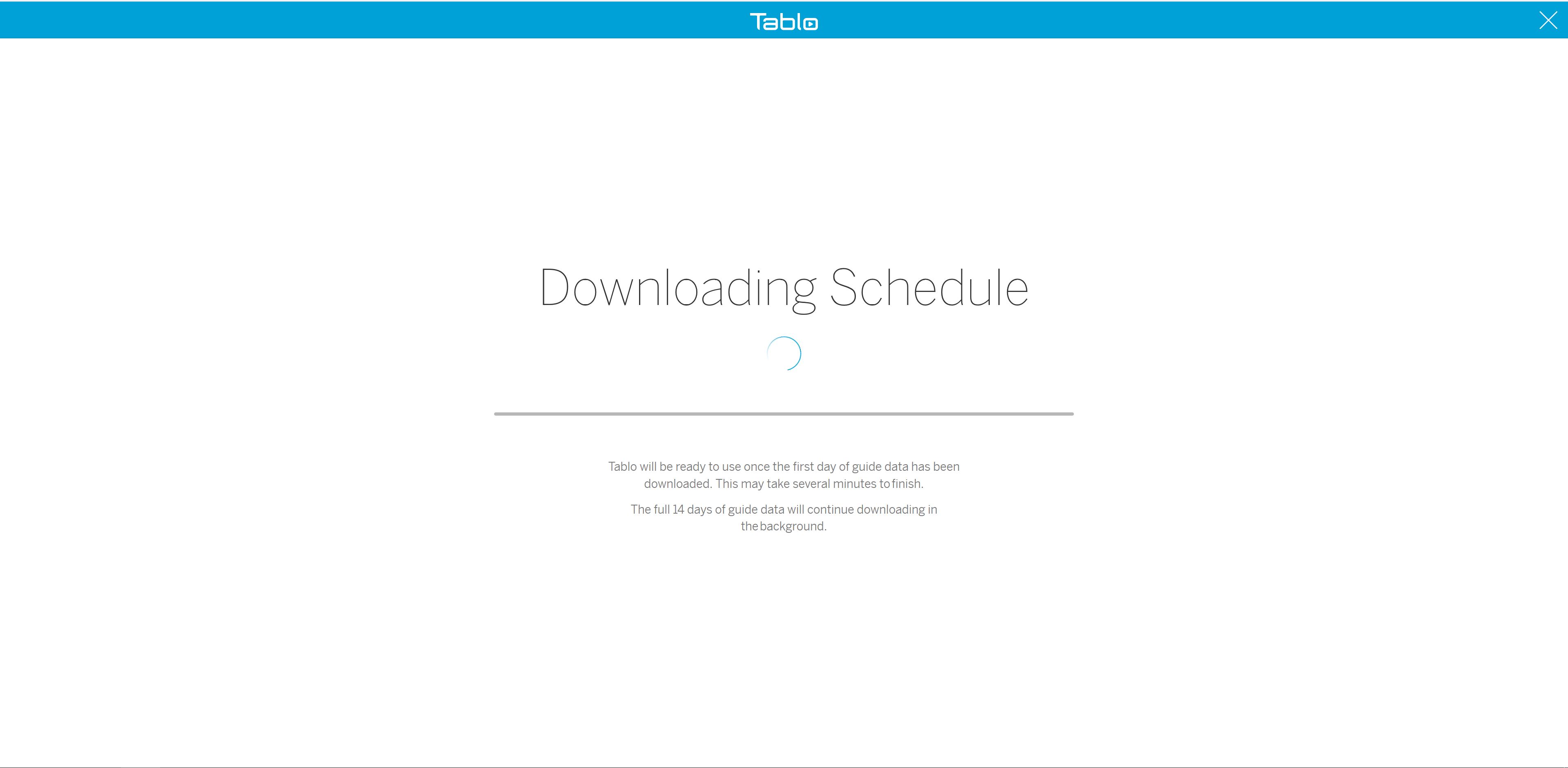

New Quad will not download schedule
New Tablo user. Received my Quad unit yesterday with high hopes of getting it running and using Roku to access it. Set-up was running smoothly until the ‘downloading schedule’ began. The spinning circle line started and just never ended with no update at all. Tried multiple times without success loading the guide. First level support tried to help, but could not get it past that point. Ticket cut and now in the hands of the next level support. Not happy. Hopefully I’ll here from them soon.

Any idea what the problem/solution to this is? I have the same issue since I received my new Tablo Quad on April 1st. Since it won’t download the schedule, I have not been able to complete the setup. I have reported this to support and my unit has been in remote access mode since Monday morning, but the problem persists. I’m thinking it should maybe just be returned if there’s no solution.

I’ve tried rebooting, restarting the setup process multiple times, using Chrome, the Android app and the Android TV app…all with the same results. The new Tablo is recognized on my network as I wouldn’t be able to get to the schedule download step without it. It confirms my guide subscription is active, my storage device is available, completes the channel scan, but then doesn’t proceed past the schedule download step no matter how long I wait.

I did the same as YARDBIRD. Been trying to get the GUIDE loaded for 15 hours. Has not loaded. Pressed blue button and started over. Has not loaded. I even paid for subscription of GUIDE and still has not loaded.
