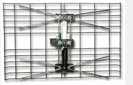

Yeah, I have an external bowtie antenna. It’s 20 years old, so I can’t find the exact model. I think it was from Channel Master. Something like this.
