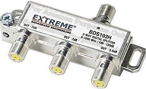

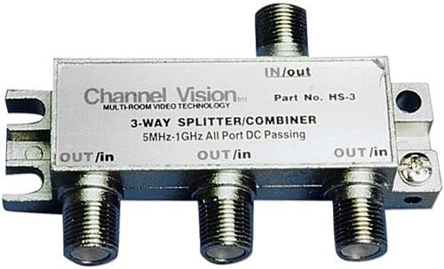

Question @Daniel454 ; how are you merging the signals from the multiple antennas? I’m just getting into this, but I have read in a few places that you can get channel interference if cable lengths aren’t exactly the same, etc…
Simple 3 way splitter / combiner… Find one with the lowest loss possible.
If buying in odd number ports, you also need to make sure all the ports have the same loss. I found even number (2/4/6) it wasn’t an issue but odd number (3/6) would often have different loss values for one of the ports.
I have used both of these without issue:

This might work fine if the 2 antennas are on the same plane and have same length cables.
The trouble you can get into with a simple Splitter/Combiner is that there could be Phase Cancellation.
What you really need is a VHF/UHF Splitter-Combiner. RadioShack site has one.
Otherwise a little VHF coming out of the UHF antenna can cancel a little of the VHF antenna signal
( and visa-versa )
@kkoceski is correct, I responded to the single question about how I was combining antennas, I did not see the post above it that indicated you were referring to combining UHF and VHF antennas…
In my case, I dont yet have ANY VHF stations, I will soon but not today, so all of mine are UHF, making the splitter / combiner linked work just fine.
