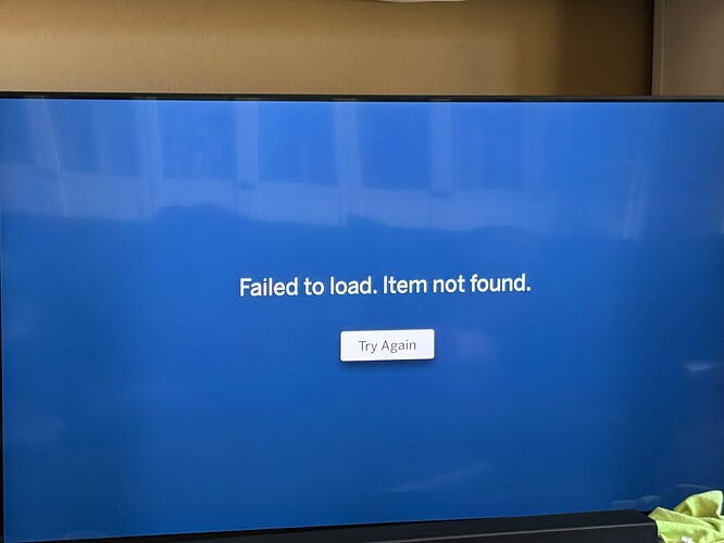

This is a new problem for me. My Legacy Tablo updated last week. Since then I have 2 and only 2 shows that are showing “Failed to Load. Item not Found.” Both shows are viewable on the Legacy Tablo app on my iPhone, Fire tv, Roku, and Google TV. They are not viewable on any of my Apple TVs (5). This is the second week since the update that I have had this issue. All of my Apple TVs are running the current TVOS. No other shows on the channel seem to be impacted. The two shows are FBI and NCIS. They are both CBS programs. None of my other CBS shows have this issue. I’m not running any beta software of any kind at this time. My Apple TVs run the gamut from an old 2017 4K model to the latest 4K model with ethernet. Same issue across the board. Last week I was able to watch on the new Gen 4 app, but I really don’t care for that app and commercial skip is important to me. I watch these programs primarily from the treadmill and trying to skip commercials is a safety issue with some inner ear balance issues I have. I also don’t want to switch devices for just a show here and a show there as that requires changing the Bluetooth connection on my headphones. But mostly I just think it’s a really weird thing to happen. Why just those two shows?

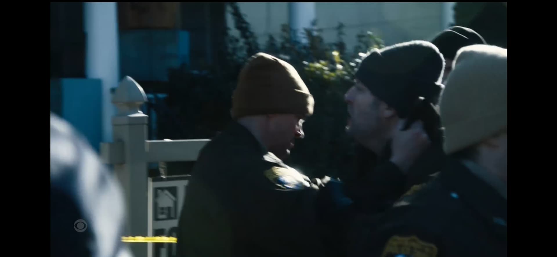

@TabloTV @TabloEngineering @TabloSupport @TabloCEO From my interaction with support, I am unclear why they want access to my Gen4 logs. As I stated the issue is with the Legacy Tablo app specifically on the Apple TV. The error repeated again last night with the recording of FBI on CBS while the program immediately following, CIA, is not affected. I’m attaching a photo of the error on Apple TV and a screenshot from the same content on my iPhone.
