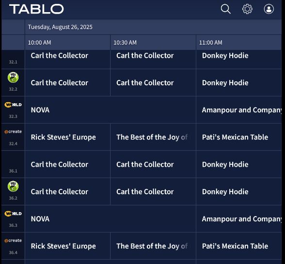

At the end of June, I bought a Gen 4 Tablo, and got it running. The Tablo Guide entries for Iowa PBS channels 32 and 36 were working fine, at least in early to mid-July. Then various weird issues and the dumpster-fire Guide madness happened. Now, from my use of various elements, the Guide seems to be working, BUT not one issue important to our household.
As a layman, what I know as Iowa PBS channels 32 (Council Bluffs, IA), and 36 (Red Oak, IA) appear on my Tablo gen 4 Guide for my ZIP code (Omaha, NE). However, on both of these channels, program names, and time segments are identical for the .1 and .2 sub-channels.
By checking a trusted online program guide, I can verify that the .2 sub-channel Tablo Guide’s program and time information is correct. The Guide’ s .1 duplication of the .2 information is incorrect.
By using the Tablo Guide to verify what is being broadcast live on the sub-channels, I can verify that the appropriate (different) programs are being broadcast on the .1 and .2 sub-channels.
If I choose to record an item from the bogus sub-channel .1 Guide entry, a recording is made for the indicated time segment, and of the program that is truly being broadcast on that sub-channel, BUT the recording is stored with an incorrect name – identifying it as what is being broadcast on sub-channel .2

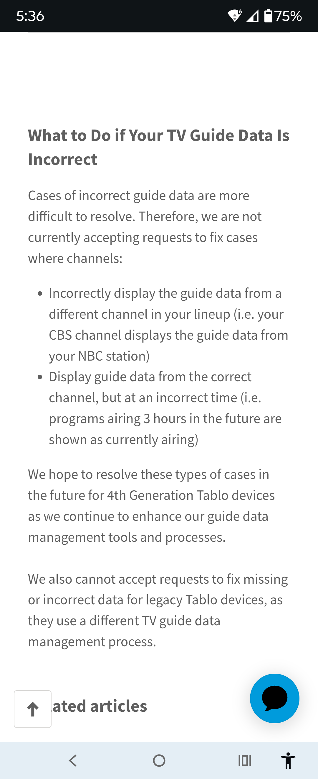

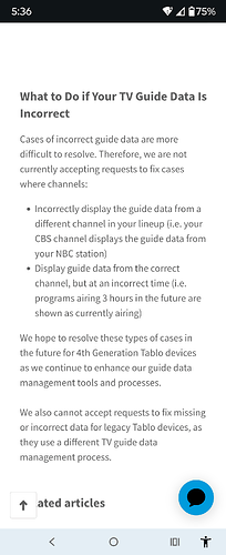

Support’s reply (09112025), with my added emphasis:
“Thanks for reaching out.
At this time, we are not accepting requests for incorrect guide data as these are more difficult to resolve.
We hope to begin accepting requests to fix incorrect data in the future as we continue to enhance our guide data management tools and processes.
Please note that Legacy models use a different TV Guide Data management process.
We apologize for any inconvenience this may cause.”

Besides my home zip code in Omaha, I also tried those for the location of transmitters for Iowa PBS 32.1 and 36.1. Still, the information shown on the guide for the .1 subchannel is not correct. It actually duplicates the information for the .2 subchannel. But, when I click the grid on the .1 subchannel, it confirms that the actual program being streamed is correct, as verified by another trusted source.
Note the above comments are about a Gen 4 Tablo. I also run a legacy Tablo, using my home zip code. The problem does NOT exist on the legacy device. The grid information for both channels 32 and 36 is correct.
