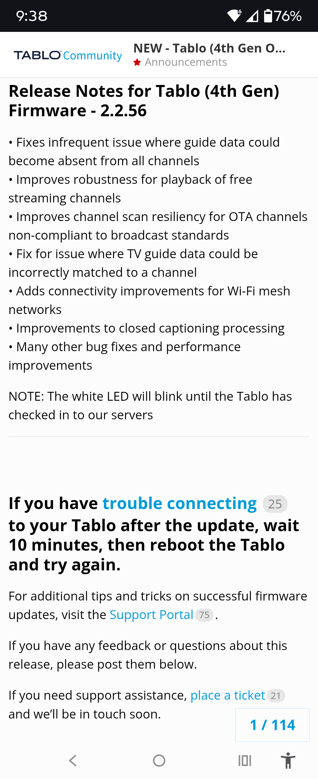

As I recall after a certain firmware upgrade, I was unable to scan and lock some channels that I previously had been doing successfully. Long distance via Tropospheric Ducting. Tablo Gen4 exclusively.

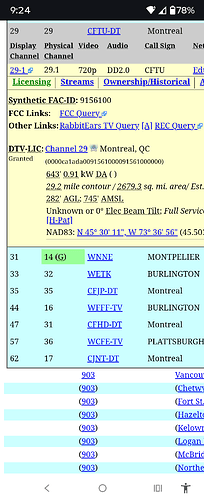

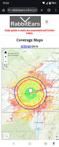

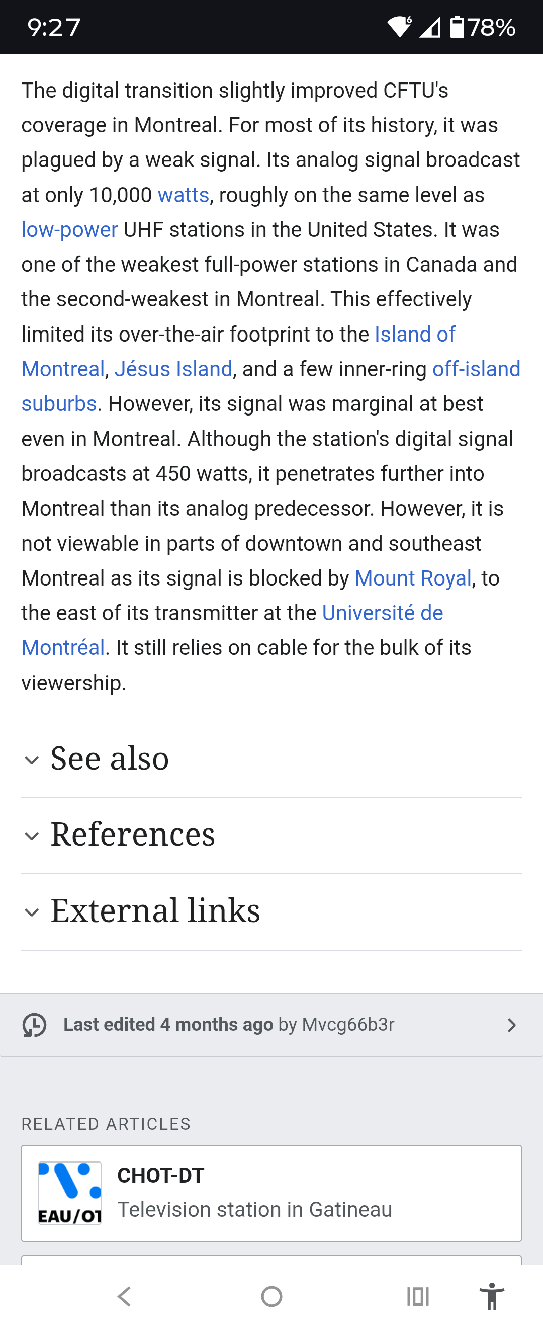

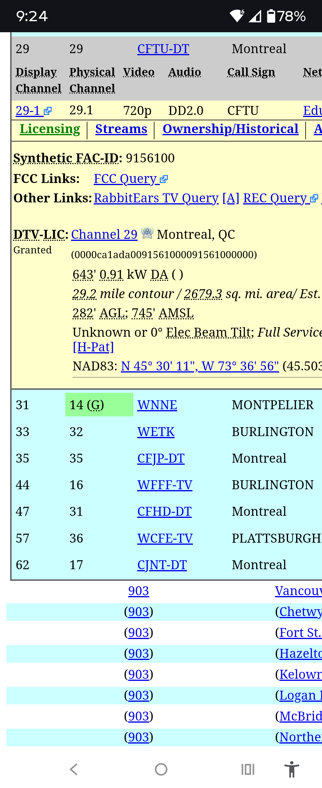

Ch29 in Montreal is one of the lowest powered stations in Canada and the second lowest in Montreal.

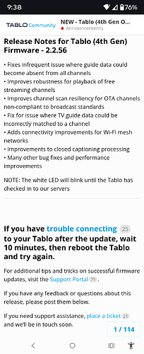

The new Tablo Gen4 apps do some calculations to determine if a signal is good enough to decode. So it’s more ‘sensitive’.
Tablo support indicated the firmware scan improvement was a change in the SNR calculations. And to ‘ensure’ compliance to standards. Meaning if something is amiss in the signal, it is no longer forgiving.
What I observed was if the Signal Strength is anywhere near midpoint or below it won’t lock anymore. Regardless of Signal Quality. With few exceptions.
So don’t rescan. And don’t expect Gen4 apps to be kind.

The signal from channel 29 was always between some very high (CBC, SRC) and low (Noovo, TeleQuebec) signal channels, and these channels were always picked up by the Tablo channel scan. Something happened between firmware versions v2.2.42, v2.2.58 or v2.2.60 that changed the way certain channels are seen besides SNR.

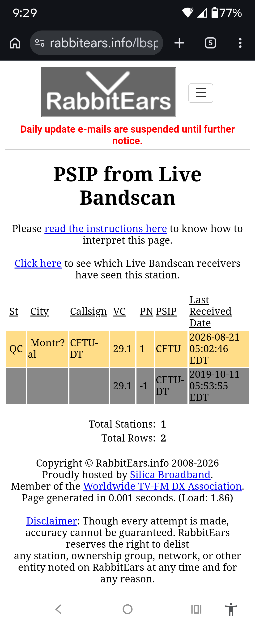

This is probably BINGO. Of course when I use roku or fire tv stick I know the physical RF and can see if the virtual channel appears and then disappears after the final channel aggregation. Of course support should be able to tell you exactly what was detected during a channel scan.

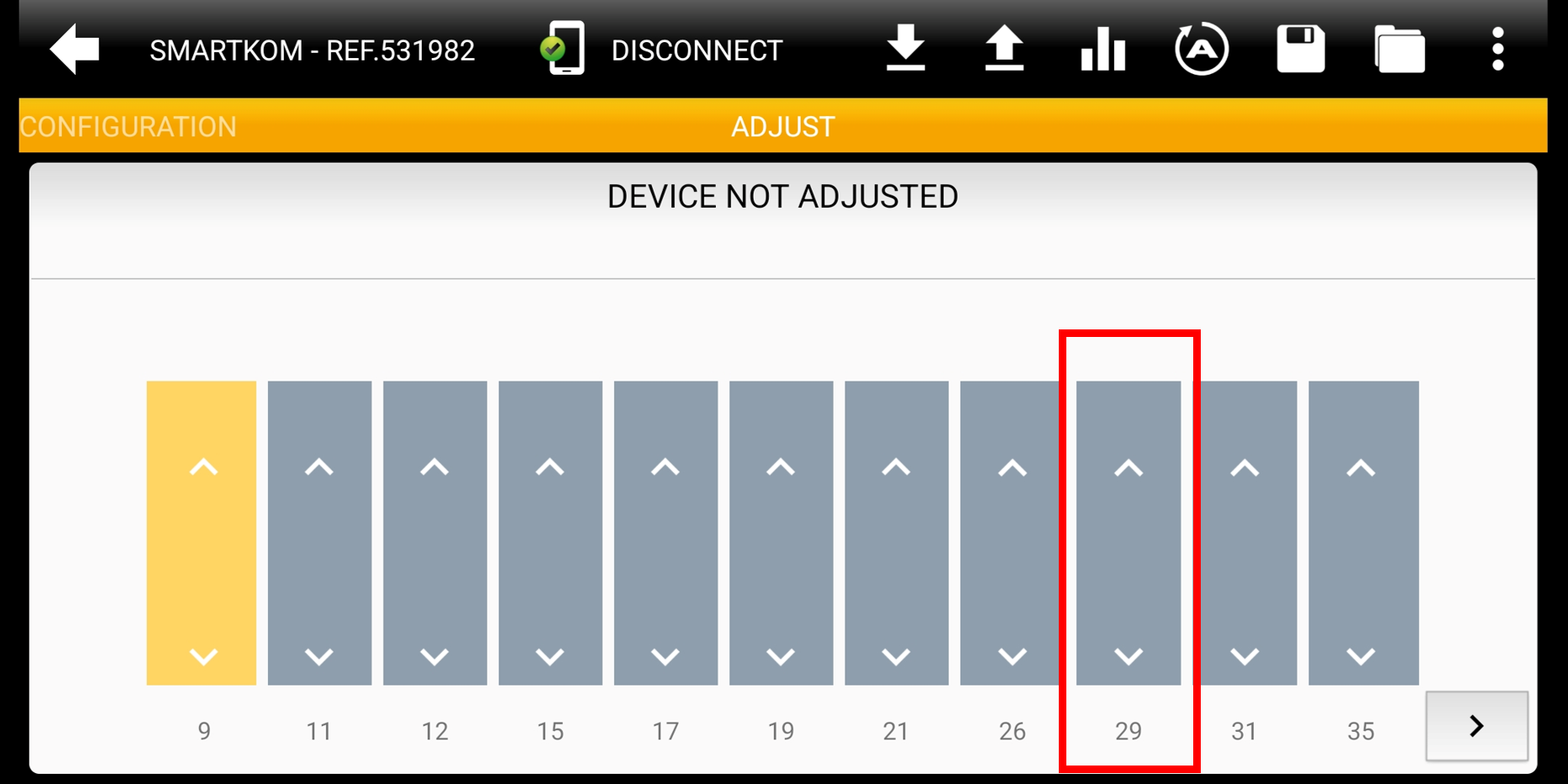

I have a Smartkom Televes preamplifier with digital signal processing, I took a screenshot of my current setup with channel 29 highlighted. I tried adjusting the gain (up and down) without any changes for the Tablo scan.
With two antennas as input and every single test telling me that every TV in my house can receive channel 29 except Tablo, and weaker channels (GlobalTV, CityTV) are still detected by Tablo, it cannot be a signal issue!
