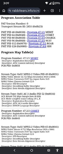

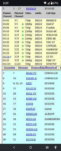

There are some LPTV experimental stations running 4K on ATSC 1.0 in Oregon also.

Eugene Oregon… I wish I could have a local experiment like that here. No ATSC 3.
Interesting! While technically possible at low frame rates, I’ve never seen a broadcast network with subchannels do that (bandwidth limit). Good find.

Low power stations have different more flexible FCC requirements. If you like the lowest possible frame rate(24 FPS) and the lowest possible bitrate then this is for you.
But only if your tuner can support those specifications. Of course the major full power broadcasters won’t broadcast ATSC 1.0 in that format

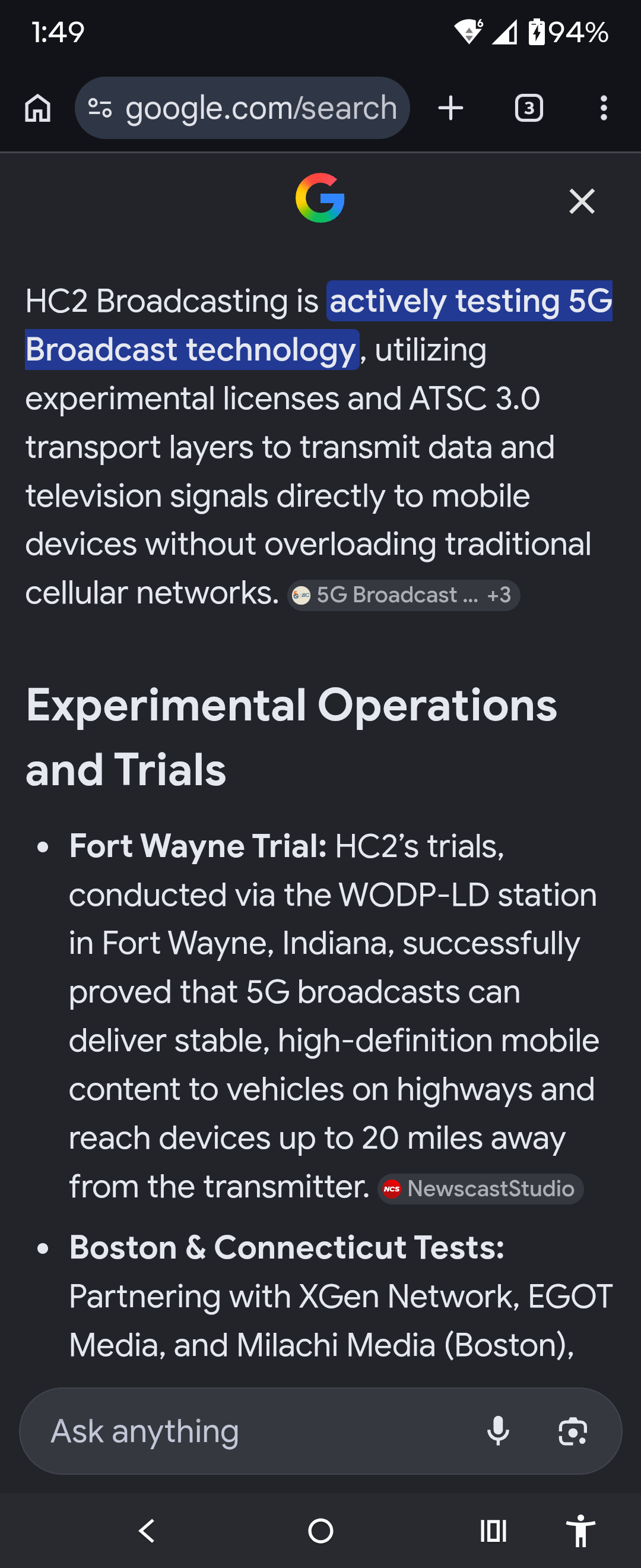

Some LPTV experimental stations are testing 5G in ATSC 3. But again A3 is not required for 5G.
So now you can watch TV on your mobile phone while driving instead of texting.

But for those who watch “TV” on a cell phone.
5G Broadcast is built into the foundational 3GPP specifications and is supported by Qualcomm’s advanced mobile modems, such as the Snapdragon X70 and Snapdragon X75. These chips are designed to process various types of spectrum, allowing devices to act as over-the-air receivers without requiring a standard cellular plan or active SIM card.

There are other applications for 5G… I was making a joke of it. New mobile phones are available this year. :joy:

Since the FCC changed the LPTV rules there has been a made dash to apply for LPTV licenses. I know of one DVR manufacturer who has applied for around 10 in various locations. All ATSC 1.0 or ATSC 3.0. The FCC is only issuing limited experimental licenses for 5G.
Okie dokie. I should have been more clear.
And then there is this…
https://www.lightreading.com/5g/charlie-ergen-s-spac-moves-to-take-over-hc2-broadcasting

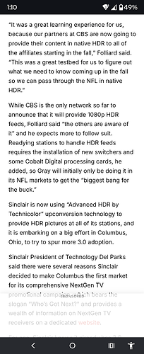

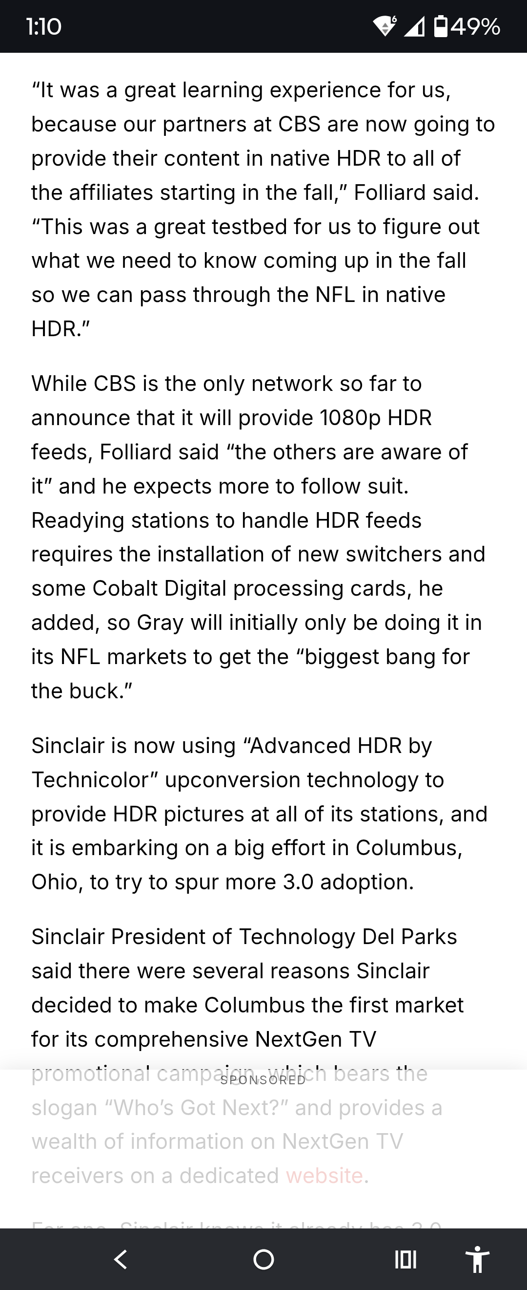

CBS announced that starting this fall they will broadcast native HDR including NFL games.
1080p for everyone!
You are going to have to move if you want this. Does CBS have a station broadcasting ATSC 3.0 in Dallas. And the vast majority of CBS ATSC 3.0 stations are encrypted. Do Sinclair or Gray have a station in Dallas.
It does say all affiliates. The overall article is about ATSC 3. They won’t be swapping out cameras just for me.
There is a Sinclair station. As of 3/24/26 it’s still 1080i.
Both CBS and Sinclair claim to be HDR for special occasions. It isn’t. It’s upscaled.
But even if the master feed was HDR the local station would have to also. Which likely blows up the lighthouse bandwidth where applicable.
