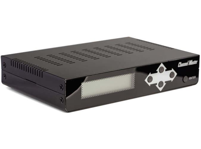

Thanks for the information. I’m pushing out live feeds from our atem video switcher and pro presenter only during service times. The flexability of leveraging the wireless network to place displays “anywhere” and not runnung wiring will justify several hundred dollars for modulators.
Thanks for everybody’s ideas and information. Is anyone familiar with Thor?
I may start testing one of these and will post results. They have an impressive customer list including NASA and many US government entities. The price isn’t that bad considering the reliability factor involved was buying from them versus a Chinese product on on Amazon.
