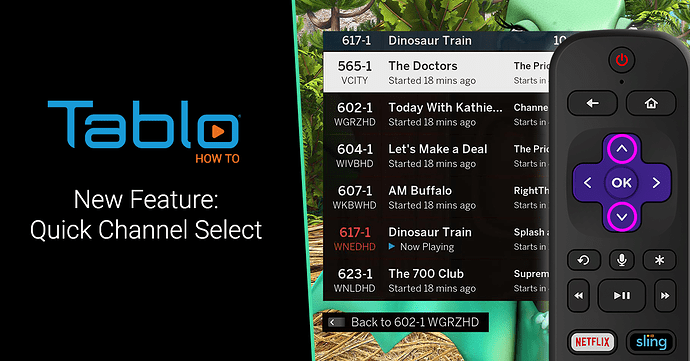

Have you tried changing channels via Quick Channel select to see if the behavior is any different?
