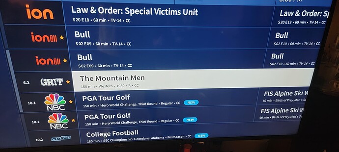

Guide issues, double channels listed 4th gen (SOLVED) kind of
SID 5087B8506893 With two of the same channels listed (10.1 and PBS), if a recording is scheduled, then the DVR won’t record either. I’m still on the 2.2.54 FW. The latest update has not hit me yet. I have tried rescanning the guide and also deselecting the channel, both channels go away, but come back when reselecting the channel. Zip code 02864

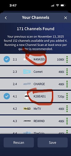

Are the duplicates showing up in the scan results, as well? If so, is there a transmitter reference shown in the scan results? If so, are the transmitter references different?
In my area, I am right between 2 low power antenna repeater farms. They have the identical virtual channels on different RF transmitter channels. If I use a non-directional antenna, I get duplicates of most of the virtual channels from the two different antenna farms. In the Tablo scan, they show up duplicated also but with different transmitter “call sign” references. The duplicates are also on 2 different RF channels.
Maybe not your situation, but it is a PITA where I am.
I circled the transmitter IDs in this screen shot. If you have duplicates where these IDs don’t match, you have 2 different sources of the same virtual channels.

Hi @Bty1968yurllo ,
It looks like you’re in the new Category View. 10.1 NBC is at the bottom of one category and then listed at the top of another.
The Favorites category appears just above Local Networks. It would make sense that 10.1 NBC may be part of both.
Are you suggesting that i remove the favorite destination? Both 10.1 duplicate channels are shown as favorites. And whatever you are suggesting makes no sense. As well as the ionplus channel duplicates are listed above 10.1 and have no channel numbers. I assume ionplus is a streamed channel.
Solved, kind of! So Ai asked me a question that I did not understand, but it made me wonder if the channel designation as favorite could be the issue. So I went looking for the channel favorites settings. Will for the life of me I can not find this setting to turn a channel favorite on. But what I did find was a setting for “Guide Options” and I had “Category View” selected, listing the channels twice if they where selected as favorites. This is a system glitch! Selecting the option for “Channels View” all is well with the guide. But this does not explain why Tom Llams is not recording, unless this is a second glitch, that when the guide is in “Category View” and listing channels twice, those channels have a conflict.
Okay so this was the case. But why would category view list the same channel twice? Both as favorites? And why would this keep the channel from recording?
