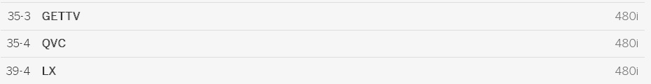

There are two issues with the guide info for Phoenix, AZ. First is KPAZ 21.5 POSTV–all the guide has been displaying for over a week now after every day’s update is “Movie”, “Movie”, “Movie”, etc. My neighbor has Tablo’s “competitor” (with the free guide) and is showing the listings for this channel so the guide data is apparently available. And KFPH-CD 35.4 shows guide info for QVC but is broadcasting Ion Mystery.

Tablo support had me edit my channel lineup, remove the two channels in question, update the guide, do a channel scan and add the channels back. The guide for 21.5 is now correct but 35.4 still says QVC. They never mentioned anything about a zip code.
Interesting, 35.4 is Ion Mystery in Queen Creek/Gilbert
Not here in Mesa. Maybe zip codes do have something to do with it. Tablo is still working with me via email on this.
