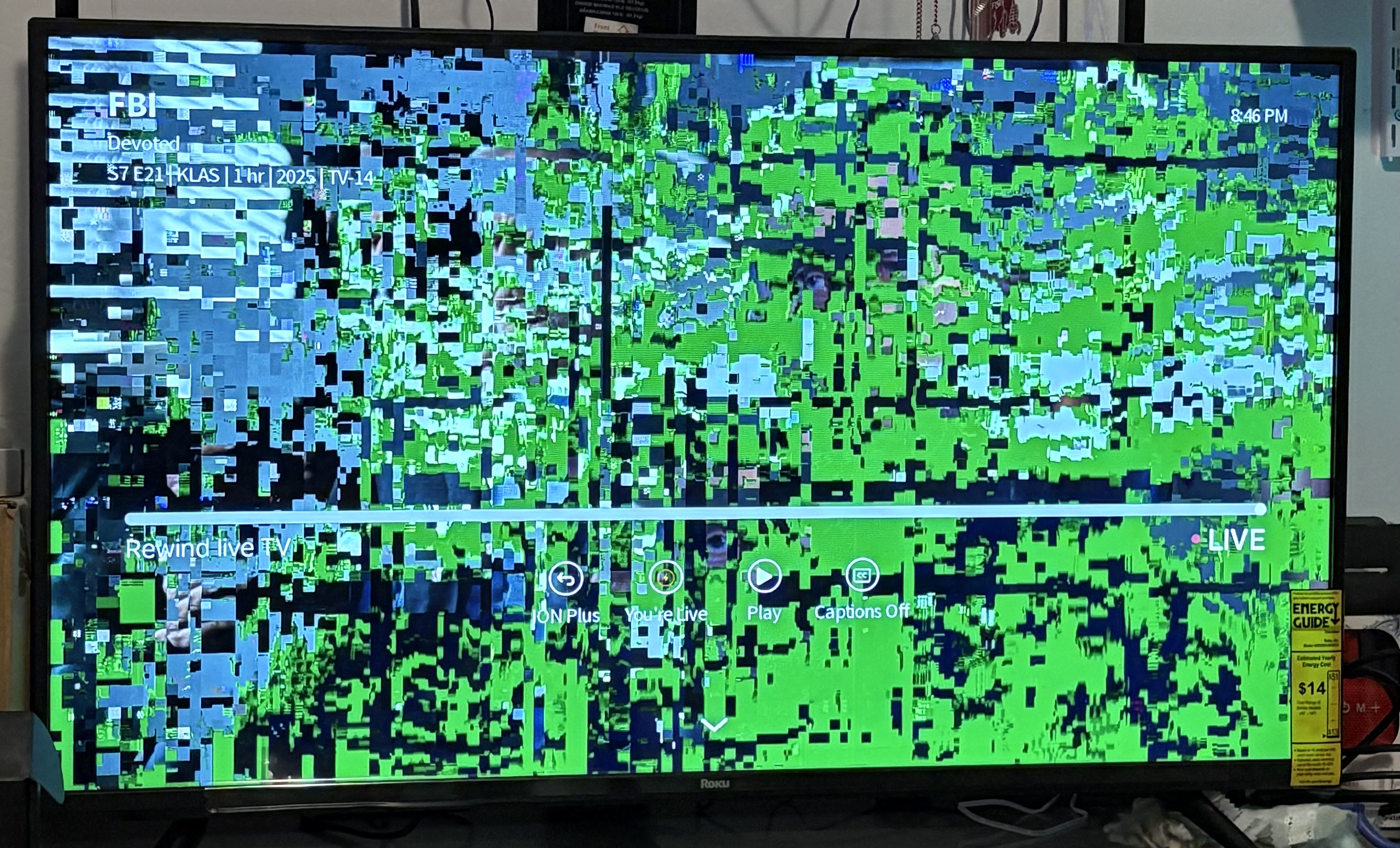

Getting some unclear and pixelated recorded videos, poor quality recording live TV Show videos
I have a 4 Generation 4 Turner Tablo unit with a amplified antenna with a External WD Hard Drive with a OBTV Filter because I’m dealing with signal issues too in my area (North Las Vegas Nevada) I have my amplified indoor antenna set in the right direction of where my Towers are, ( they are slightly behind me) I’m told I should have my antenna facing East which they are.
And have a new Roku smart TV
This is Beside the point.

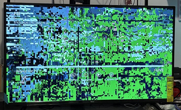

I was watching one of my favorite TV Shows in live recording when it started to become pixelated with some little buffering then stopped! I am very unhappy and frustrated that this has happened! Plus the rest of the show probably got recorded BUT the rest of the show became pixelated I couldn’t finish watching the show because it buffered and stopped and it just looped.!
My other second show that came on after that, failed to record! Another show of mine also became pixelated during the recording process, it got recorded but with bad reception with pixelated picture
Plus I’m always resetting my Tablo Unit because it becomes disconnected or the Tablo app crashes on my Roku TV
Now I have to wait til early in the morning to rewatch my show on Hulu or paramount or Peacock.
There is a Third FBI Show that I’m waiting to see if it gets recorded or not? The FBI Shows a CBS network.
Again I have disconnected the external Hard Drive.
This will with or without my external Hard Drive connected to my Tablo unit.
Does anyone know why this is happening or have a solution?
Not very happy:(

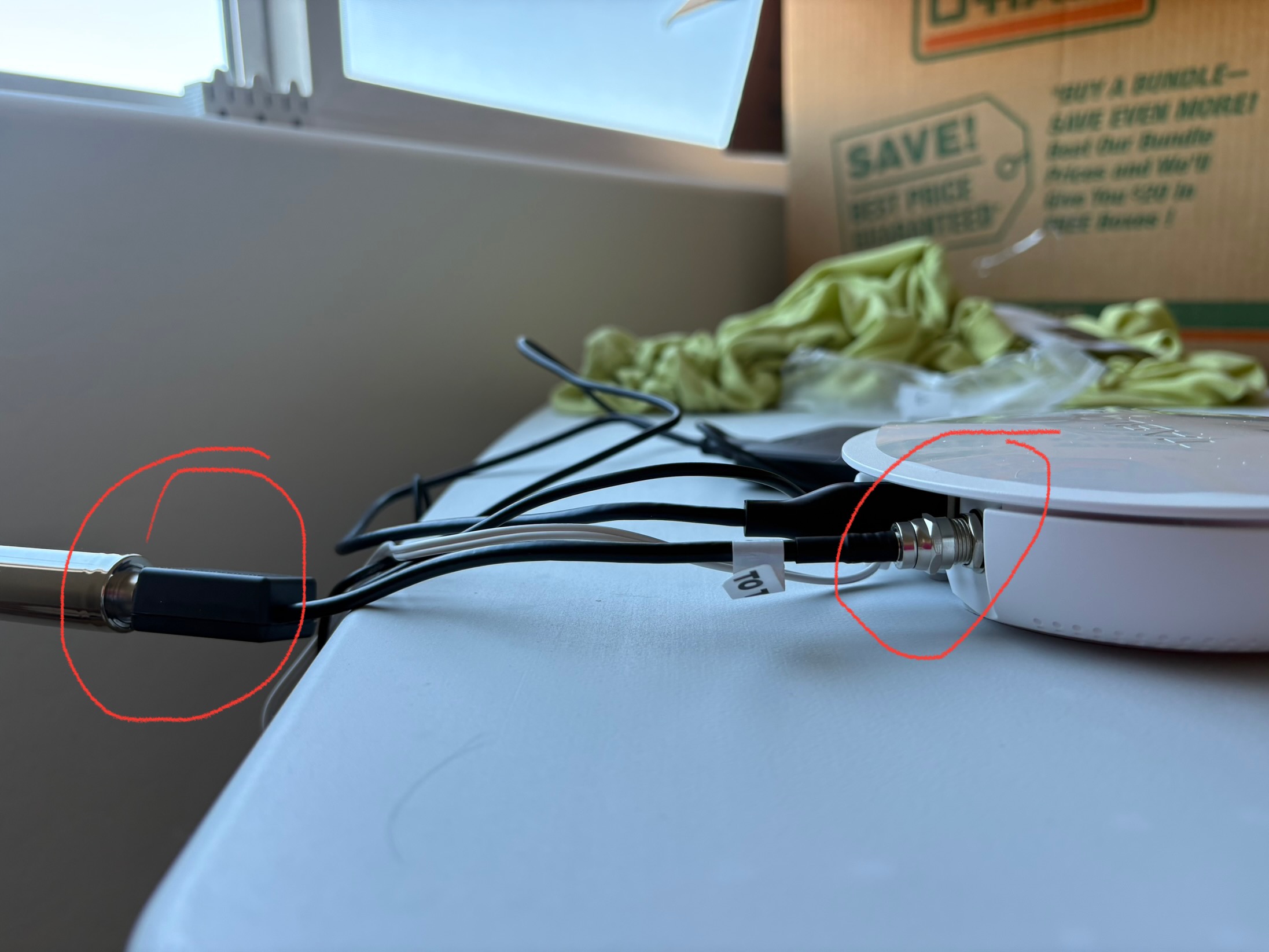

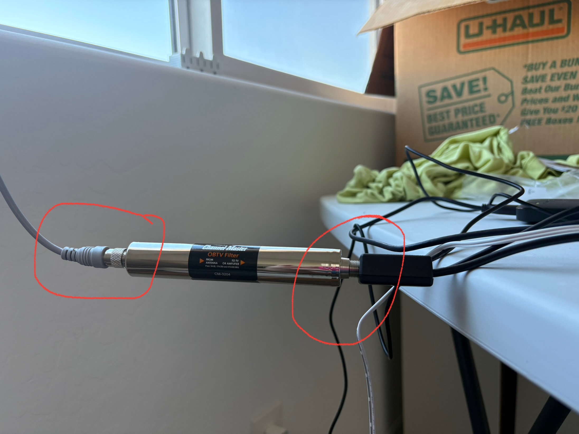

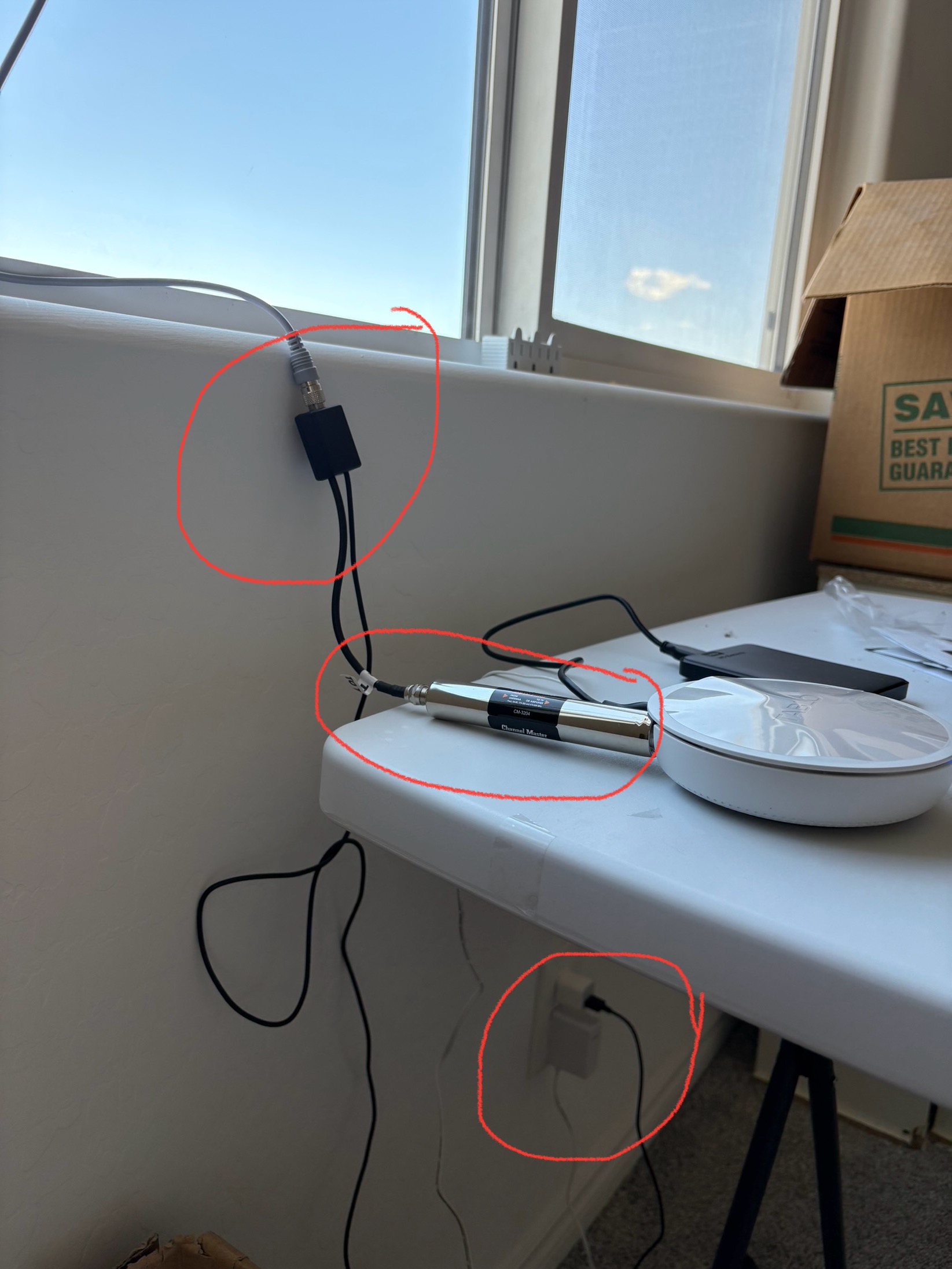

I did have the Jolt switch hooked up to the Tablo unit and the OBTV Filter hooked up behind the jolt switch and had the other end of the OBTV Filter connected to the antenna coaxial cable, but today I switched it over, I connected the OBTV Filter to the Tablo Unit and the other end of the OBTV Filter I connected the Jolt switch and the, The jolt switch to the amplified antenna coaxial cable, I have attached a picture of what I did, after doing this I reset the Tablo unit and then went into the Tablo app on my iPhone 16 plus into the Tablo app settings and did a channel rescan, still didn’t get that MeTV Channel.

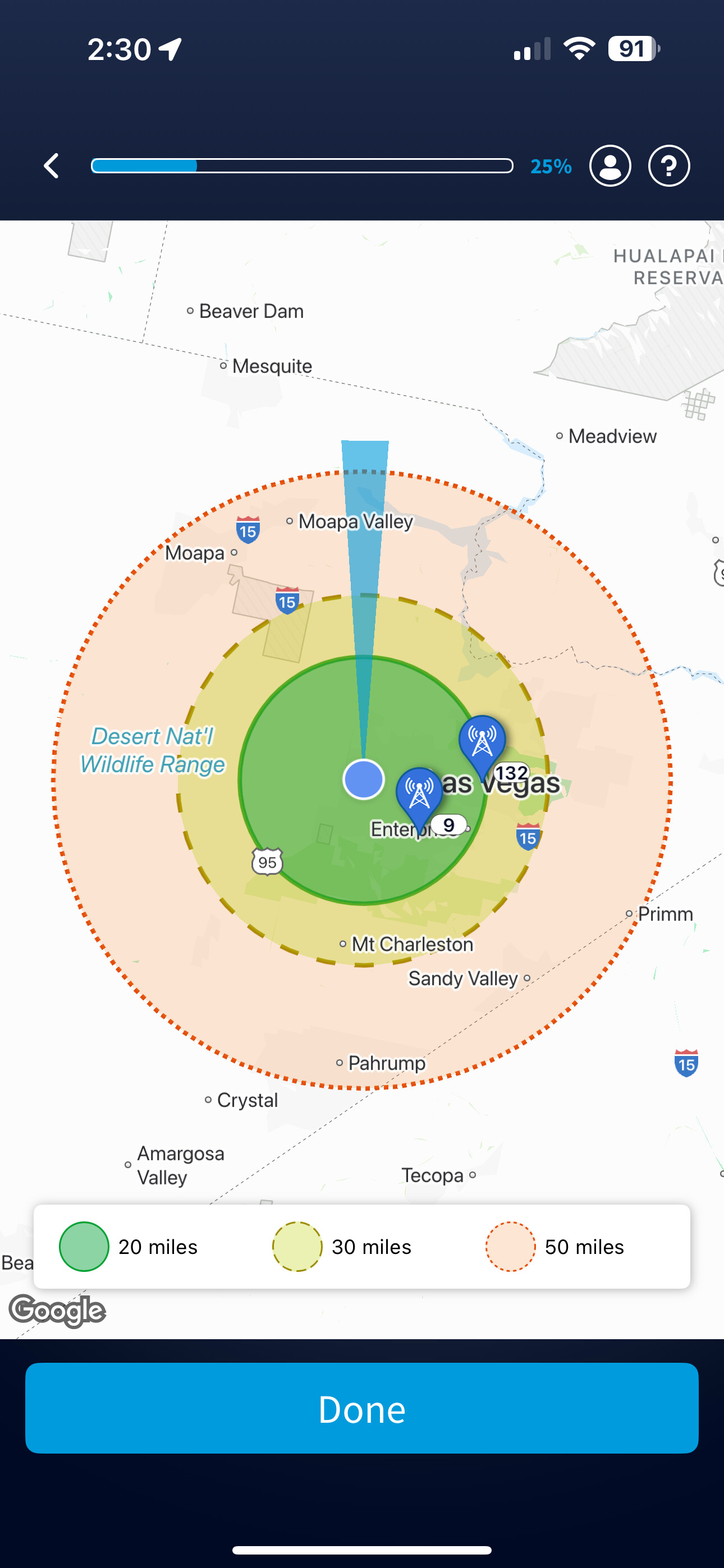

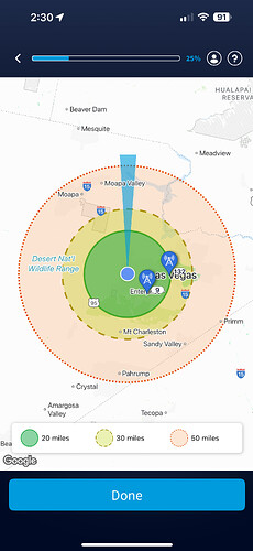

If you go back in the rabbit ears website put in my zip code 89084.
The amplified antenna coaxial cable is built into the antenna under the antenna itself, it can’t be removed.
We can’t put an outdoor antenna because of our HOA If we had put a outdoor antenna on our two story house we would have to do paperwork and wait weeks or a month for approval from our HOA plus we don’t a specialized person to install the outdoor antenna on our roof because I don’t want my husband to do it I’m afraid he’ll fall off and break his neck, our house is really tall! And to hire someone to out to install the outdoor antenna would be a bit expensive!
In looking at the photo you provided, if I’m not mistaken, I think you would want to put the OBTV Filter between the antenna and Jolt, then plug the Jolt amplifier into the Tablo device. This would remove interference and then amplify the clean(er) signal going into the Tablo.
If the Mohu antenna is on the 2nd floor on the side of the house facing the direction the antenna farm is located, you should be able to receive most of the GREEN and maybe some YELLOW channels shown on RabbitEars.info. I don’t know how much I would trust the validity of the antenna range claims.
RabbitEars.Info - Signal Search Map

We have a smart Roku TV it is located on one side of the room and wall, our Tablo and antenna is located by and on our upstairs bedroom window
I don’t know if my husband would want to pay that much for an antenna? We can’t have a outdoor antenna on our House because of our HOA BUT if I put it on the back end of our house where the antenna is suppose to be, our HOA Won’t be able to see it?
This is where we would put the antenna, upstairs window either outside of our upstairs window or inside of our upstairs bedroom window

That’s what I did before (pictured before I changed the connection) and I wasn’t getting the MeTV Channel?
