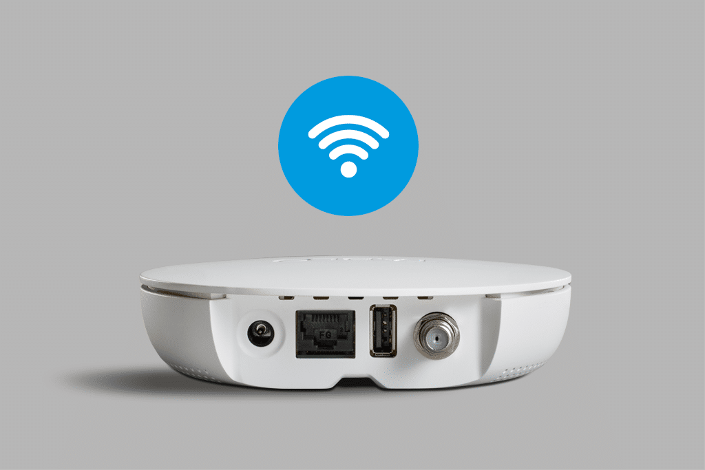

I set up my 4th gen Tablo for ethernet.
I now want to move it to a different room in the house, so need to have the device be wifi connected.
Is there a way to move a 4th gen device from ethernet to wifi? I can’t find any way to do that.

I checked with Tablo support. Here is the response I received. I’ve not tried it out yet.
If you want to switch from Ethernet to Wi-Fi, first remove the Ethernet cable from the Tablo, and then reboot the Tablo. To reboot your Tablo, press and quickly release the reset button below the Tablo box. When the Tablo’s blue LED slowly blinks, it is ready for wifi setup.
The Tablo will then boot into Wi-Fi setup mode. Instructions for this process can be found in the link:

The instructions provided by Tablo support worked.
The only extra point, is that I had to clear the data cache for the Tablo app on my phone, delete the Tablo app off my phone, reboot the phone, and reinstall the Tablo app. Once I did that - this process worked, and I was able to connect my 4th gen Tablo to wifi, even though I’d originally set it up for wired ethernet.
