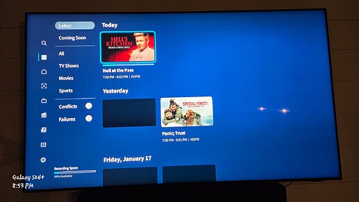

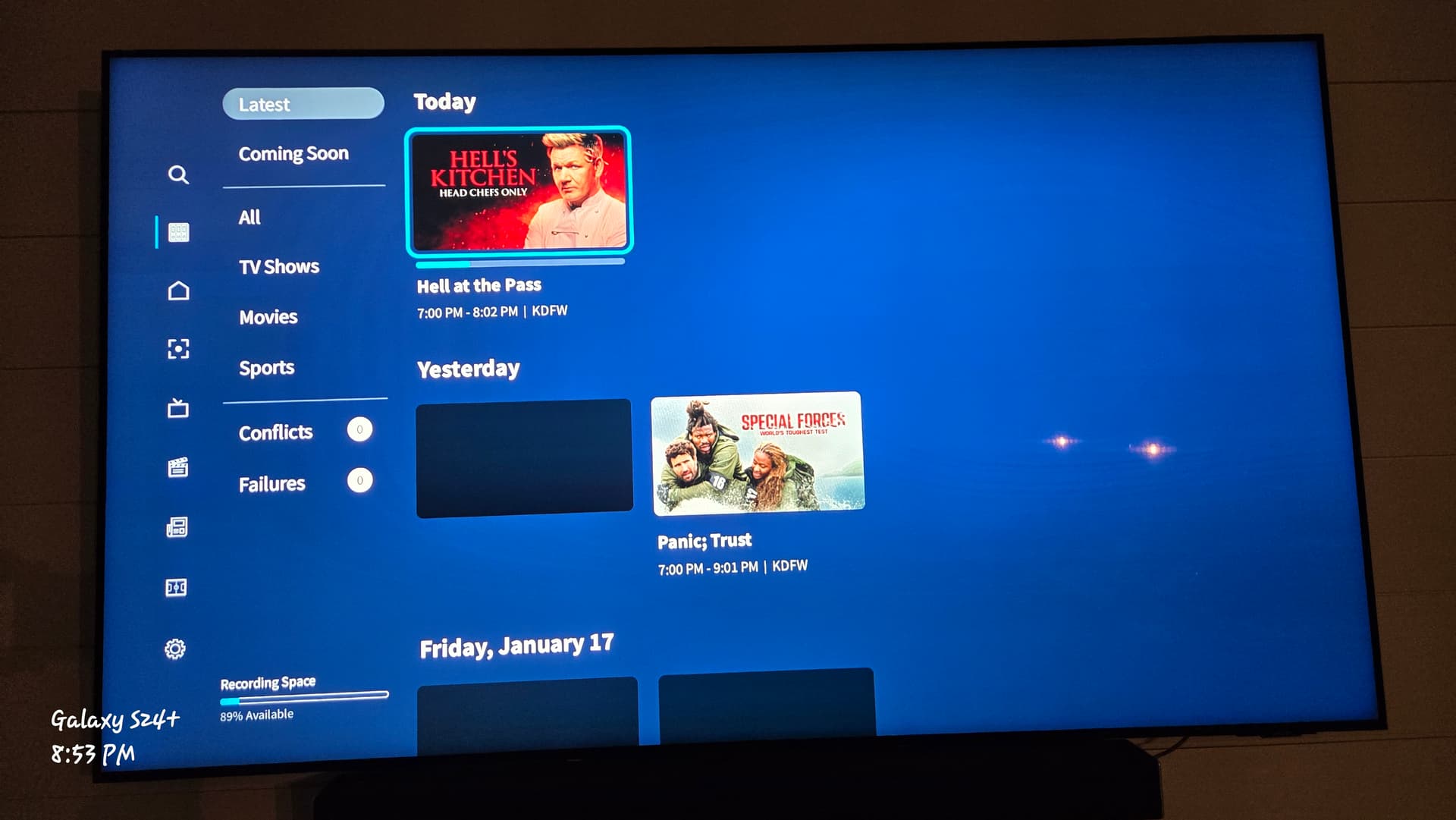

In the middle of watching the HK recording, the TabloTV app restarts and when we come back this is what we see.
We had to wait a few minutes and keep going out and back in for the images to load just so we could select the HK recording we were watching:

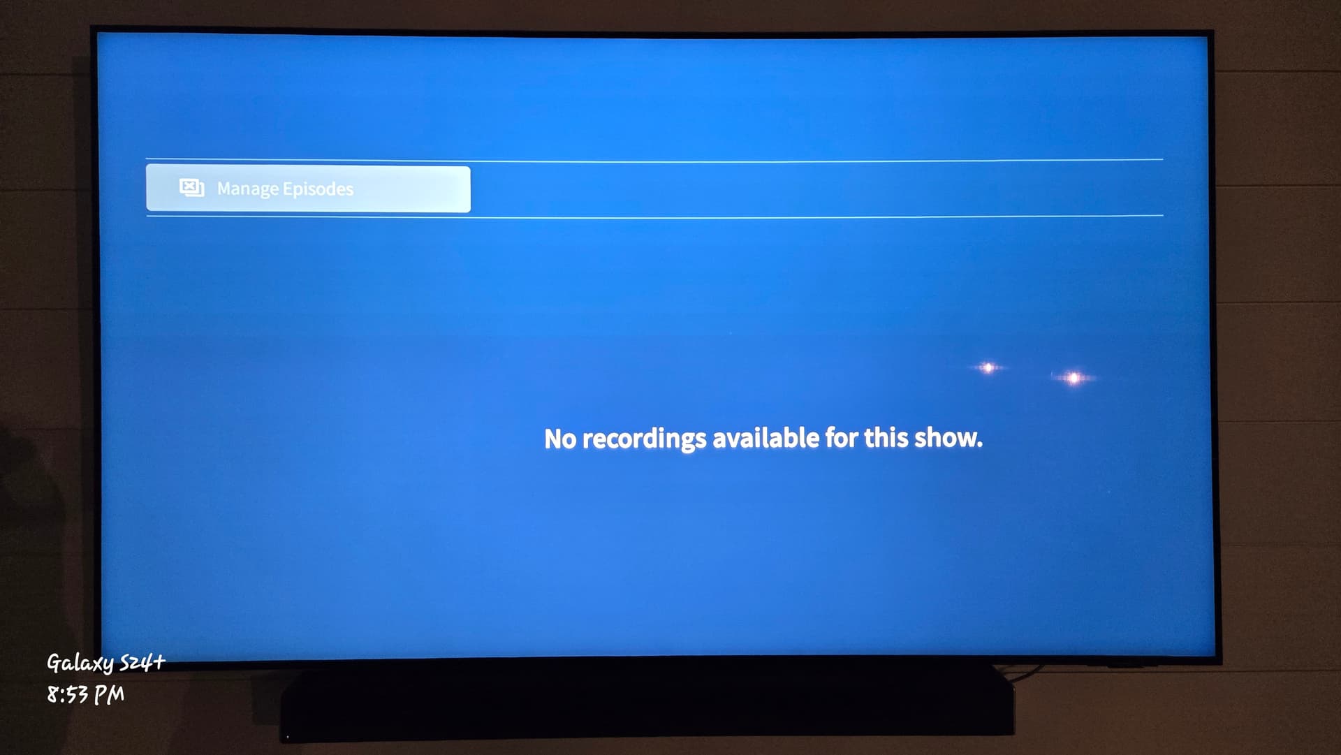

Then we get the HK icon and click on it, and we get this:
We were just watching this show! What the heck is going on? This is 5-6 minutes of frustration that shouldn’t even be happening. We’re starting to get fed up with these restarts/reboots/disconnects/inconveniences. We usually have 2-3 restarts during a show but we usually don’t have this issue where the TabloTV App doesn’t report the recordings OR the Fire Stick can’t retrieve them. Wasted money on a new Roku, and now a new Fire Stick Max. Now taking the TV off the wall again to go back to the Roku because it wasn’t as bad as this, but at least it was manageable.
