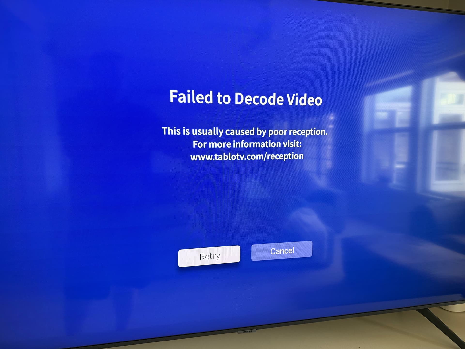

I am new to Tablo and have been running the 4th Gen device directly connected through ethernet cables. I use either the Tablo app on my Samsung TV or through an Amazon Fire TV Cube. I consistently get the “Failed to Decode Video” error when trying to tune into a live channel. Selecting ‘Retry’ doesn’t help.
I usually have to exit the whole app, restart it, and hope for the best. Sometimes switching between the Samsung and Amazon apps can help, but not reliably. The antenna is in an IDEAL location and I am less than 30 miles from the transmission tower. Firmware is current on all devices involved.
Any suggestions other than returning the Tablo as it’s almost unusable for its core function?
