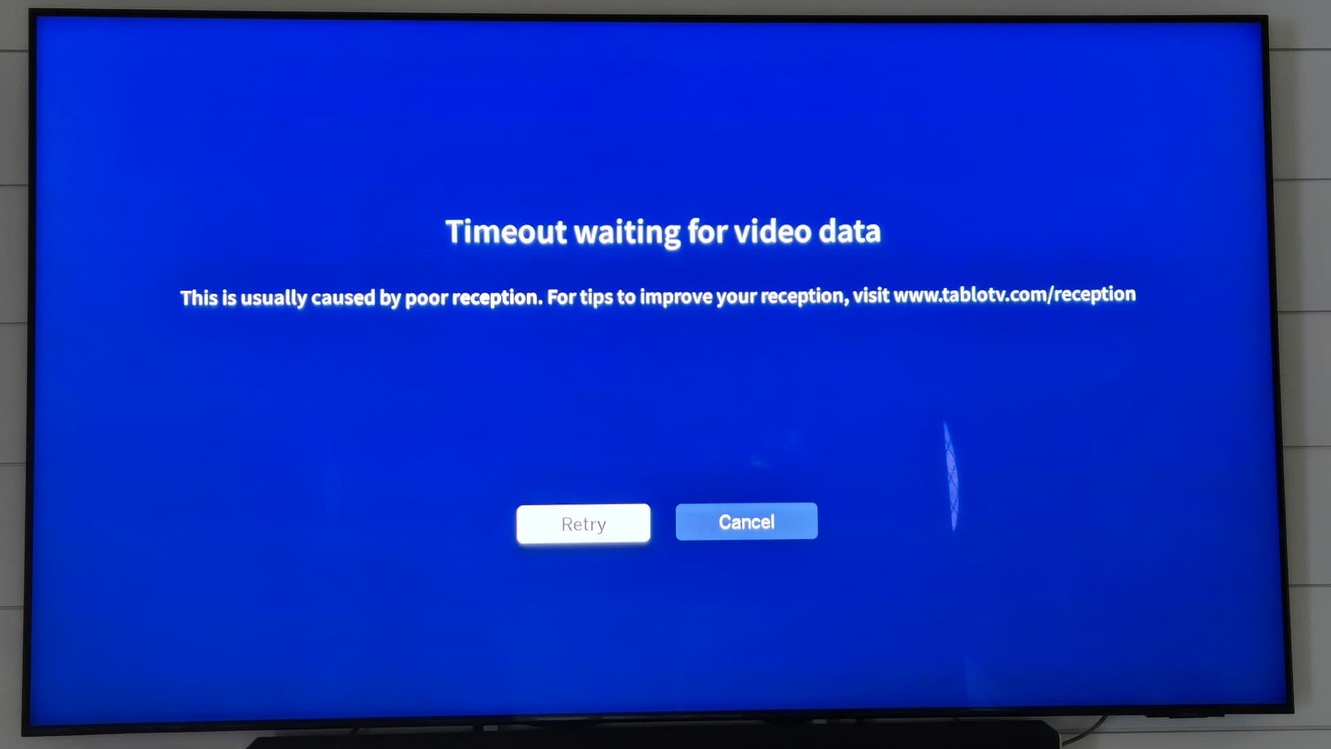

We’ve been out of town since Fri, 8/15 to last night but, ya, we saw this sporadically in the early evenings beginning early last week in the CDT zone. Thankfully it was only 30 sec or less of Spinning Wheel, Got To Go Round.
EDIT: that’s funny - after I was done typing and submitted this I looked up and saw a “Timeout waiting for video data” error. Retry cleared it and it’s back up and running again. This isn’t something we typically see, but it just occured 4x within 10-11 minutes.
