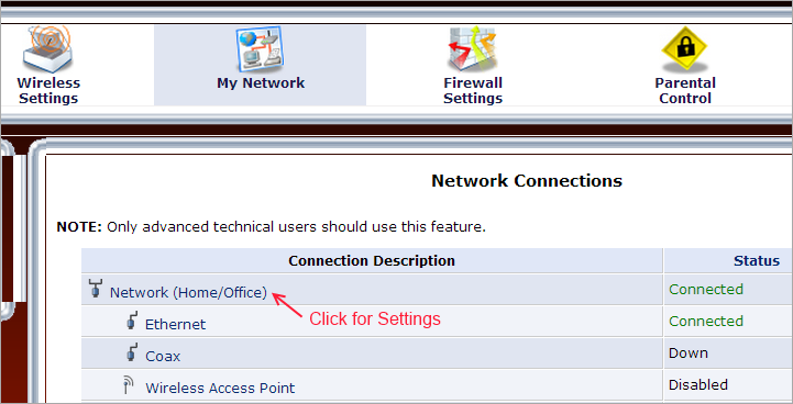

You need to put your in Verizon FIOS router MI424WR bridge mode. Right now you have a router behind a router.
Here’s how to put it in bridge mode.
