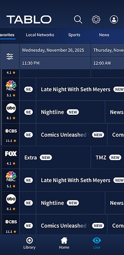

Why am I seeing channels duplicated in the listing?

This is the same problem that I have reported twice. It’s Android phone app.

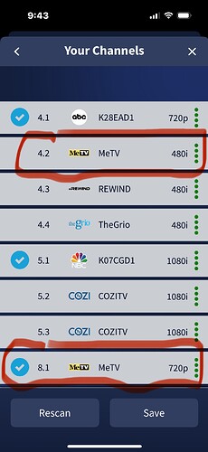

Are these duplicates coming from the same transmitter? Sometimes the same virtual channel can come from 2 different transmitters (2 different antenna farms). I have this issue in my area.
Check the Tablo channel scan results and see those virtual channels are repeated under 2 different transmitter IDs.

It was just a thought. I eventually switched to a directional antenna for higher gain on the transmitters I wanted, and good rejection of the duplicate transmitters on different RF channels I didn’t want.
I’m curious … are these guide duplicates also shown in the results of the Tablo channel scan, or do they just appear once in that list?
I should add … there are still 2 transmissions of MeTV from 2 different transmitters in the same antenna farm in my area. One is a 720p/5.1 “8.1 main channel”, and the other is a 480i/2.0 “4.2 sub channel”. I just check the higher quality 8.1 version, and don’t check the lower quality 4.2 version in the Tablo scan list. If I checked them both, I would get 2 instances of MeTV in my guide.
Only in the list(s). When in Category Guide mode it builds a table array for display. So if you go to the program list and go one by one until the category changes on the left you can see it function.
But click on the Category and it displays the first program of the category on the forth line. The first three lines are the previous category. When you have fewer entries in the table like you do and the OP… It displays as dups.

My MeTV thing FYI …
If I use a non-directional antenna, I get complete duplicates of every virtual channel from 2 different antenna farms located in almost opposite directions. PITA.

After clarifying with the product team, we learned that when a channel is featured or favorited, it will not be removed from the other categories. For instance, favorites and locals are next to each other in the guide; a favorited local channel will appear in both and seem to be duplicated.
Okie dokie it’s working as designed. I removed all the Favorites and that guide is now empty. I have redisplayed each category and although I can see that some may perhaps be miscategorized, the overall indexing issue does not reappear.
It’s curious that the ‘Kids’ category (and a few others) only has a single entry - create This Old House - a very popular childrens program… But the entire screen is populated by other programs from the next category.

For the Fire Stick 4k G2… Removing Favorites made no difference. Each category displays the three last entries of the prior category.
